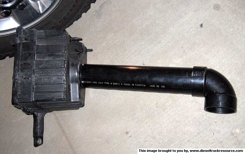

$7 of 4"ID PVC with a 90* elbow...takes the cooler air from the backside the front stock bumper...
I wonder if I need that addition to my airbox?????????????????????
Actually would the bottom of my box hold up to having that mounted?????????
before you drilled yours out it would have but I don't know about now??
I...Actually would the bottom of my box hold up to having that mounted?????????
If it helps, I also attached the downtube to the innerfender to stop it from shifting around.
The intake is behind the stock bumper but sticks out with the ARB,...still trying to decide if I should shorten it or not...
it's hard to see in this pic so I highlighted the intake in yellow...
