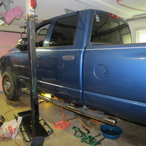

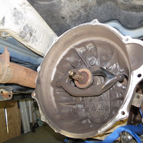

Finally have the transmission out and think it'll be fixed once I get it back together. It was a bit of a pain being tight in my garage, but since I didn't plan on pulling any of the parts from under the truck, figured it was doable.
Throw-out bearing is dry and would have totally gone not to much longer. Can tell by all the rust dust and how rough it feels. The shaft is dry and while easy to move the bearing, I'm sure it was very hard to move once it started pushing on the pressure plate. The spline is dry and slightly corroded, so will need some good detailing.

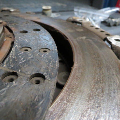

Clutch and pressure plate are okay without damage. However, the clutch was getting close to needing replacing anyhow.

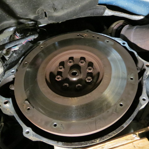

The flywheel is near perfect. Except for being able to feel a texture difference between the clean and dirty part, there is not feelable wear. The pilot bearing still has what you may call grease, but it is close to being dry too. Except for polishing the flywheel surface with 180 grit emery as recommended in the service manual, I don't plan on replacing it. Question is if I need to pull it to change out the pilot bearing?
Still need to check the fork for wear, but doubt it will need replacing.

If you're putting a new clutch in then it's a must to have the flywheel re-surfaced. Any clutch shop can do it. Only takes a minute. The last thing you want is a new clutch wearing against a worn flywheel.....kinda like putting new brake pads on warped rotors.
If you don't plan on working the truck then a stock type replacement will work just fine. Valeo is an economical choice.....SouthBend and Valair also make quality units as well, just a bit more money. Do a search for replacement clutches and you'll come to a conclusion.
