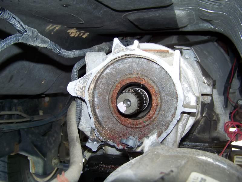

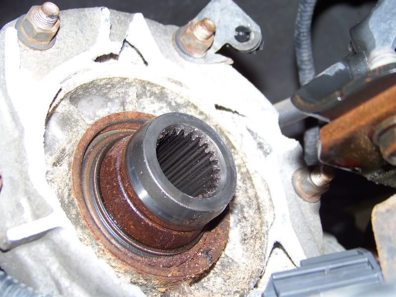

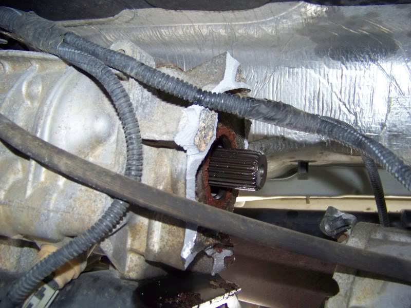

Here's are some pics guys.
DISCUSS.....

Old Apr 11, 2010 | 07:25 PM
1985cucv's Avatar
Joined: Apr 2008
Posts: 1,960
From: wisconsin
thats pretty wild!

I would say a flaw in the casting. If the u-joints you replaced were in pretty good shape, there could not have been that kind of damage started before you replaced them. I do not think flipping the D-shaft would cause any problem. Even if it would, it would not happen on the first run out.

What is the red wire going to? It does not look factory.
