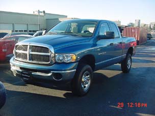

Cool,
Thanks for the replies...looks like I will make the jump to the bigger tires..tirerack.com has a special on them now for 117.00. Will be about 676.00 to my door. Looks like Ill wai until the truck gets here to make measurements on both truck and trailer before purchasing the hitch.
Toby, did you have to install the leveling kit to prevent rubbing? Looks like our trucks will be quite similiar!
ALoha,
Mike

Mike - I actually installed my leveling kit the night before my tires arrived, so I don't know if my particular truck would have rubbed or not. Some do, some don't, it's all about the tolerances. At any rate, you've got great taste
-Toby
