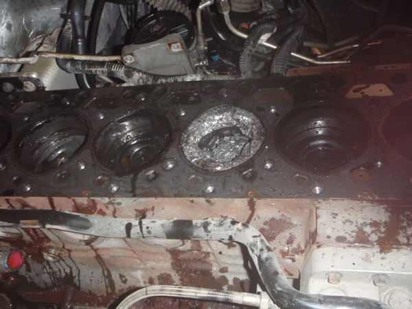

Looks like dropped Valve!
Pulled head and Number 3 piston was beat apart with 3 Broken Valves!
Ouch, nice "carnage" shot though.

From: Live Oak Texas
Sorry about the bad luck but that is a great picture of the carnage!
If the $3800 engine is still available, I would jump on it quickly!!
