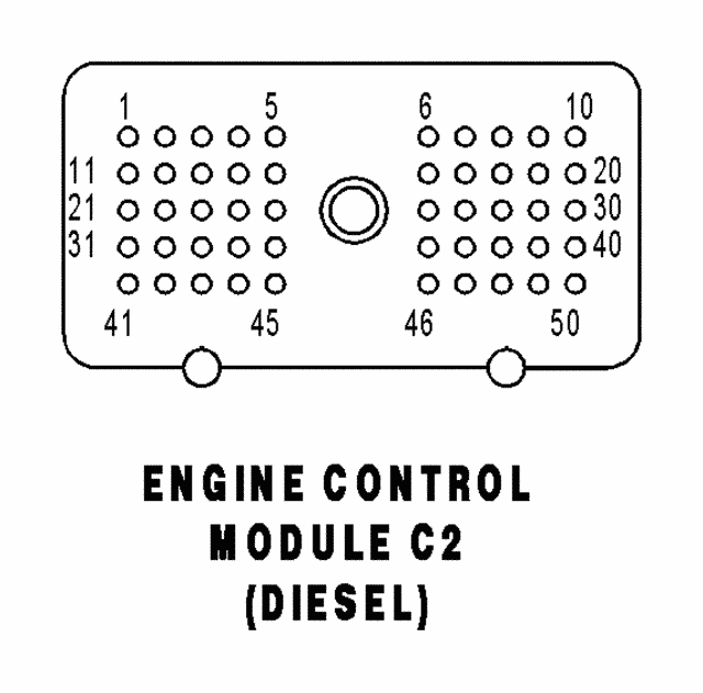

Without a scanner it will be difficult to diag. You need to monitor cam and crank signal, fuel pressure and if any codes are setting. You checked all the fuses?. Pins 20, 30 and 40 are 12 volt power to ECM. Pins 21, 49, 50 are grounds
