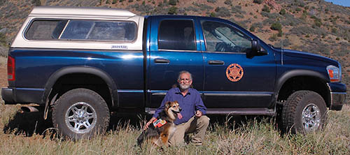

From: Arizona
17's
here's my truck with 17's, I like to have more rubber between the dirt and rims...:
