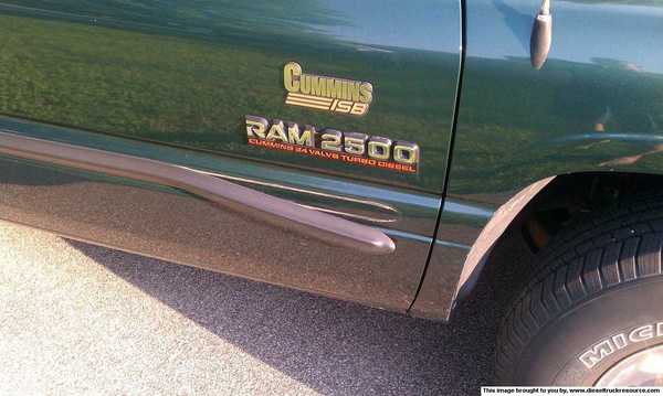

The door trim on my passenger door is peeling off a little bit. What should I use to glue it back on?

3M Trim Adhesive is wonderful stuff.
You could glue a brick to the side of your truck and it would stay.
Most auto parts stores carry it.
Follow directions.

3m double sided tape

if you never want to take it off again use windshild urathane

If you want the correct product that can be removed in the future, the OEM is 3M double sided adhesive tape. There's actually a few different grades of 3M tape. The product made specifically for body molding has foam that is thinner than the typical double sided adhesive tape found at the big box stores or Staples. You can pick up a small length of it at a local body shop. Keep in mind, surface preparation is key when installing the tape.
