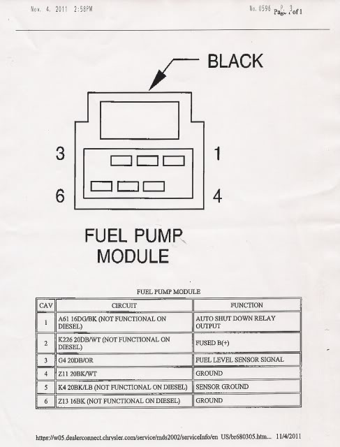

Schematics for troubleshooting fuel gauge issues
I got these from the dealership, they're for a 96, but should work on some of the other years. Figured someone else might be looking for these. Hope this helps some.
