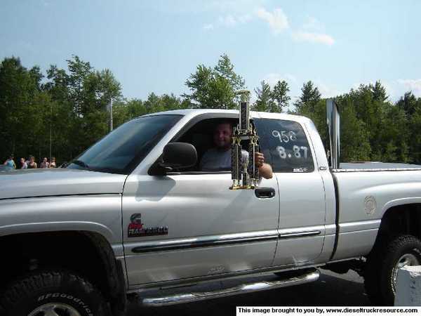

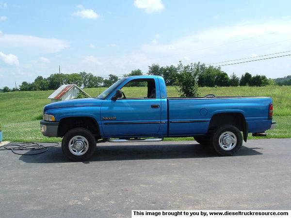

It wont work, see in this pic the bottom of the door is rounded
and on the quadcab the bottom of the door is squared off
