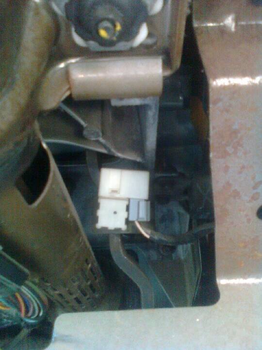

New here, Just bought a 98 12 valve 5 speed 4x4 eclb. I noticed the brake lights aren't working. Seems the stop light switch is unplugged, and I cant for the life of me find where to plug it in. I'm stumped. Can someone maybe post a pic of where it plugs in.

Had to have my knee bolster off today, here is a picture, easy cheesy.

Let's just say, The problem wasn't the switch. Turns out the Brake controller was wired wrong causing it to blow fuses.
