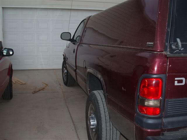

So I am doing the research to do this to my 96 3500. I have a set of wheels and tires. and I am looking to yank the fenders off for now until i have time to go pick up a bed.
I have seen pics that looks like once you remove the dually fenders there is a fuel door in the regular bed. My question to anybody who has done this conversion is that true or is this picture of a bed someone has added the door to?
A temporary thing but I would hate to get all the way down to pulling off the fenders only to find that I now have to figure out how to attach the fuel filler to something that doesnt exist.
Thoughts?

The rear axle spindle width should be different. Not sure how that will affect going from dually rims to single rims. :conf:

1 Attachment(s)
i used 2500 wheels an a bed from a '95 2500
Attachment 49155
KATOOM Aug 24, 2016 07:24 PM
Well there ya go. :thumbsup:
sanddragon2004 Aug 24, 2016 11:37 PM
So 1 unaswered question I had was I see these photos of there being the factory fuel door there on the factory fender is that the case?
https://cimg9.ibsrv.net/gimg/www.die...3e7d723f49.png
johnh Aug 25, 2016 02:05 PM
as far as i know the fuel door is the same on all the beds dually or single
