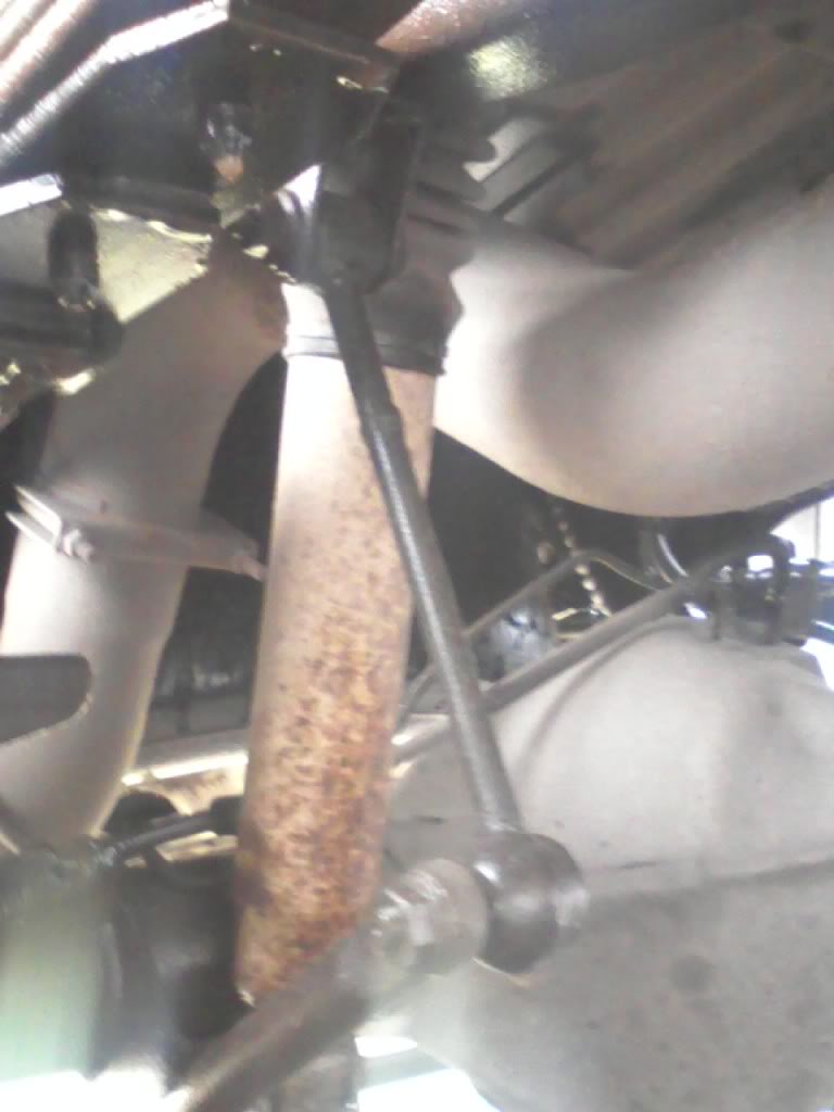

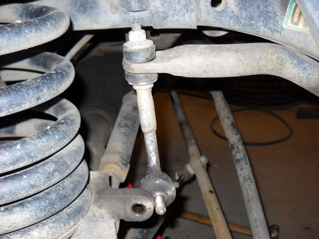

here is a pic of my homemade swaybar links, have 50$ and 1/2 of time invested in making 4 of them, cut the old dodge ones in 1/2, as well as the new carivan ones, use a piece of tubing and slip both ends in and weld it up
the rears I just ground to a taper and butt welded them
