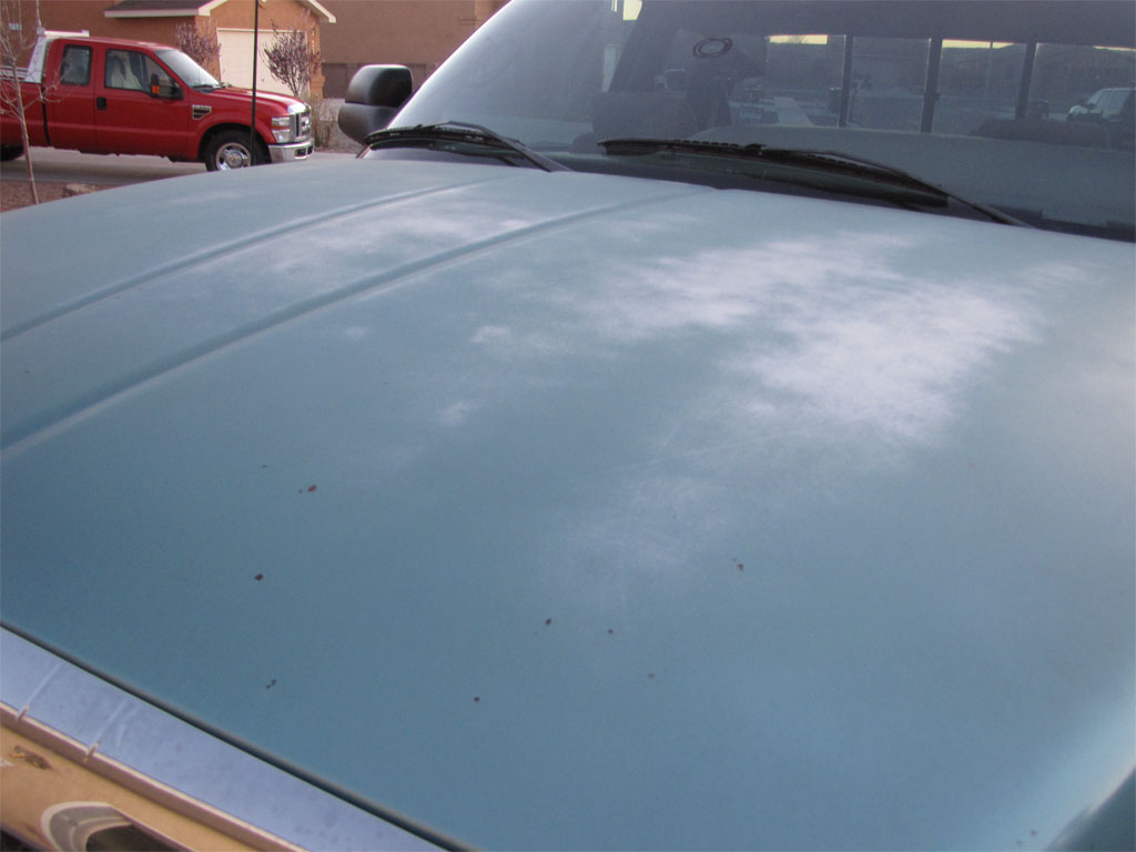

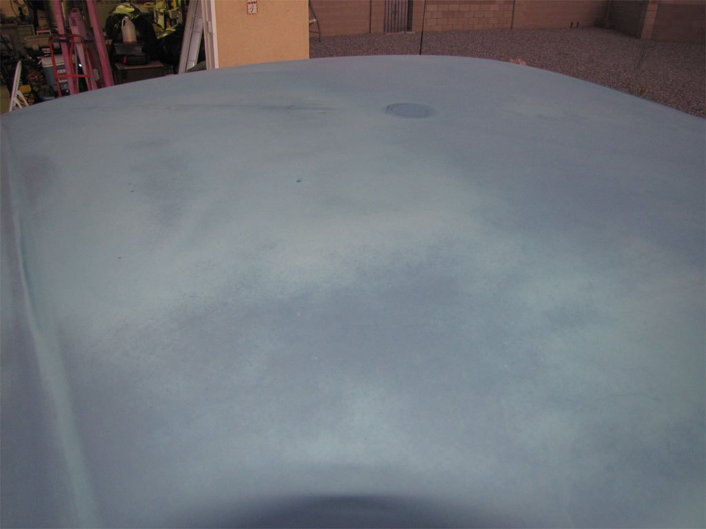

I've got a truck thats only peeling on the top of the door. The hood and roof have clearcoat thats going bad.
I was wondering can you just tackle each section a little at a time? What I mean is, I would like to do the roof first, see how it comes out, then maybe a month or two later when I have time, pull off the hood, refinish/paint it, and so on for the tops of the fenders etc... Is this possible? And with the description of what
Even though my truck is not my daily driver, I just don't see myself taking a month or two to tear it all apart, paint, then put it back together (like JLENT has done, but I wish I had the time to do it like that). This is especially since I use the truck for camping during the warm months when I could paint, but I really like camping and so does the family so cancelling that would make us all go crazy. If I had the money, of coarse, I would have someone do it. I'm not looking for showroom, just nice enough that with a nice polish/wax and 10ft it would like real shiney... and most importantly keeps the rust out.
I was debating on either going the Aerosol spray route from one of the paint sites, or cheaper HVLP gun. I've got a 30gal oil cooled belt driven compressor rates around 6.5cfm @ 90psi. I'm thinking an air DA would be out, but what about HVLP? Which would be recommended for doing small sections at a time?
Any comments?

What color is the truck? If its not a metallic color, you can panel paint the entire truck. If its metallic, you will need to blend the door into the surrounding panels. Blending is done like this....each coat that you put on after full coverage has been acheived will be reduced by 25% each time & each coat will be extended by 6" overlap from repair area. I hope you understand this.

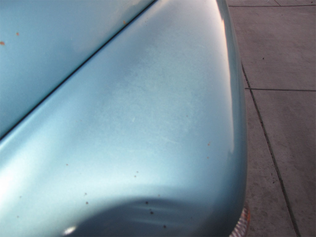

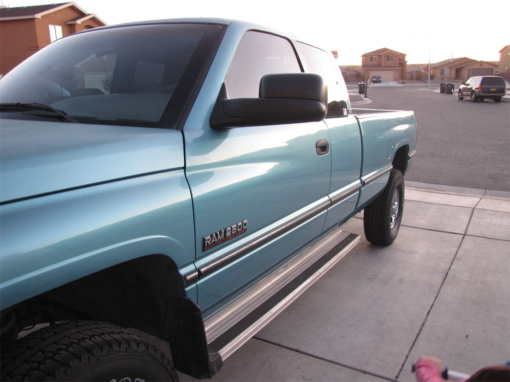

PQE is the color code. It's a Aquaish or green color. I wasn't really looking for a truck in this color, but with a good polish/wax I love how the truck looks and wish not to change the color.
Not sure if this is metallic or not, but I think it is.. I didn't think you did multiple coats. I'm pretty painting stupid right now, never done it and no one I know has done it. I've read up a little over the years, but nothing that gave me the ah-hah! I'm looking for.
I would like to get more info on this 25% thing, but I think I would be wasting your time until I could get more familiar with how many coats are needed and how you tell, then perhaps I would understand more on this 25% thinned out, 6" overlap. I'm not even sure how to tell how much paint, primer etc to purchase.
Do you have some good places, books/sites/whatever that would get me going in the right direction?
Here is a couple pics...
