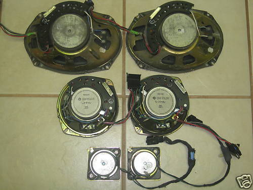

Unfortunately, the speakers were hijacked and replaced with some crap ones. My truck was originally equipped with the, "Infinity," system, but only the tweeters are left. I reconnected them on one side, as the wires were spliced just past the factory connector. The other connectors are still in place, and it looks like they were simply bypassed by some cheap wiring, run straight from an aftermarket head.
I would like to purchase the factory set-up, but the components are elusive and/or super expensive on eBay. I know that the stock Infinity speakers were constructed with an amp on each 6"x9," and it seems like the factory stereo reads the resistance of the system before any output is distributed.

From the research that I've done over the last couple of days, it seems that the standard sound system consists of 6"x9" speakers in the front, and 5 1/4" in the rear. The, "Infinity," system is pretty much the same, but the front 6"x9"s have an amplifier attached to each speaker.
I wouldn't mind substituting the speakers, but I will at least need the harness plugs that came fixed to the Infinity speakers, because I really don't want to hack off the wiring any further back.

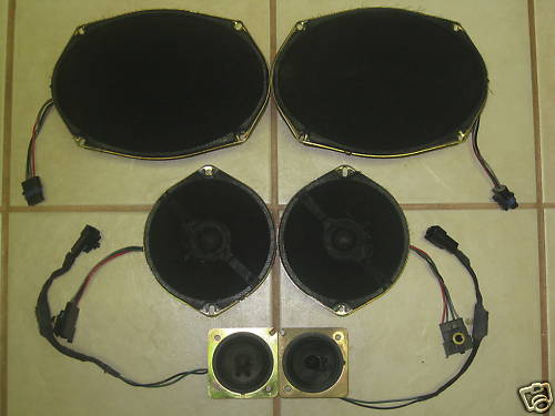

The doors each have a black, ovaled, 4-pin receptacle, and I believe the back speakers have a rectangular 2 or 4-pin connection.
The tweeters are intact, and they have a square, black, 2-pin connection.
does anybody have proof where the infinity radio's amp is?i replaced my stock speaker's with aftermarket one's and i'm still running the factory deck.if what is on the speaker was truely an amp it would have more wire's going to it.i believe it to be just a crossover,which i just zip tied to the new speaker's
Superram, I went back and checked my FSM and it says that the infinity speakers in the front door have "intergral dual 30 watt amplifiers". One of the amps powers the front speaker and tweeter, the other powers the rear speaker for the respective side of truck. I can't confirm the location, but the term "intergral" tells me that they are with the front speaker.
Except for the tweeters, the factory connectors on the speaker side were discarded along with the speakers.
Does anyone have a set of speakers like this, or at least the connectors? Or is there a company that sells direct replacement speakers with factory connectors?
