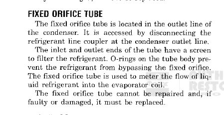

I have a 1996 Ram which has recently had a condenser replaced. The gauges now show an increase in pressure on the low side when engaged.
I suspect this is probably the orfice may not be installed, but I am not finding information on where it might be.
Does someone have a layout of a 1996 Ram a/c system showing components?

Don't have a layout, but this is from the FSM.
1996 Ram a/c Components-97-orifice-tube.jpg
