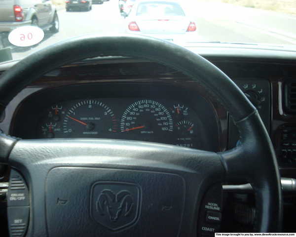

Old Apr 29, 2007 | 01:58 PM
dssimecek's Avatar
Posts: 520
From: Cypress. Texas 77433
Here is a pix of how hot I run. Also checked the coolent tempature at the Tstat housing on the head, it read about 185
This was about a year ago, on I-10 in Phoenix, stopped in traffic.
