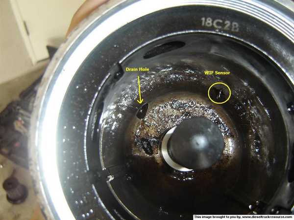

Here's what mine looked like with 10,000 miles on the filter with regular LSD about 2 years ago. Took this picture when I did the lift pump change.
eww thats pretty nasty. supprisingly enough since i got the truck its never looked anything like that. and my filters usually come out black as ashphault when i change em

Wow, that canister has a lot of stuff in it
I must be lucky with the fuel I am running...my filters come out somewhat black after 10,000 km( i know only about 6250 miles,lol) and i'll have a few little particles in the bottom of the canister.

That canister may look bad, but it is doing its job. I would rather sediment collect there than the VP44.
BTW, my filters come out black as well at 10K.
