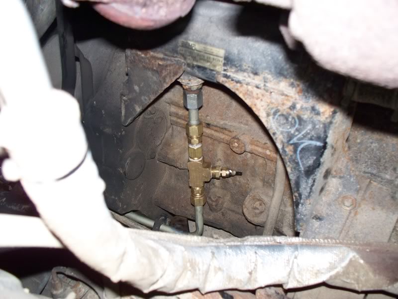

Best spot is to install the probe in the hot line leading to the transmission cooler.
