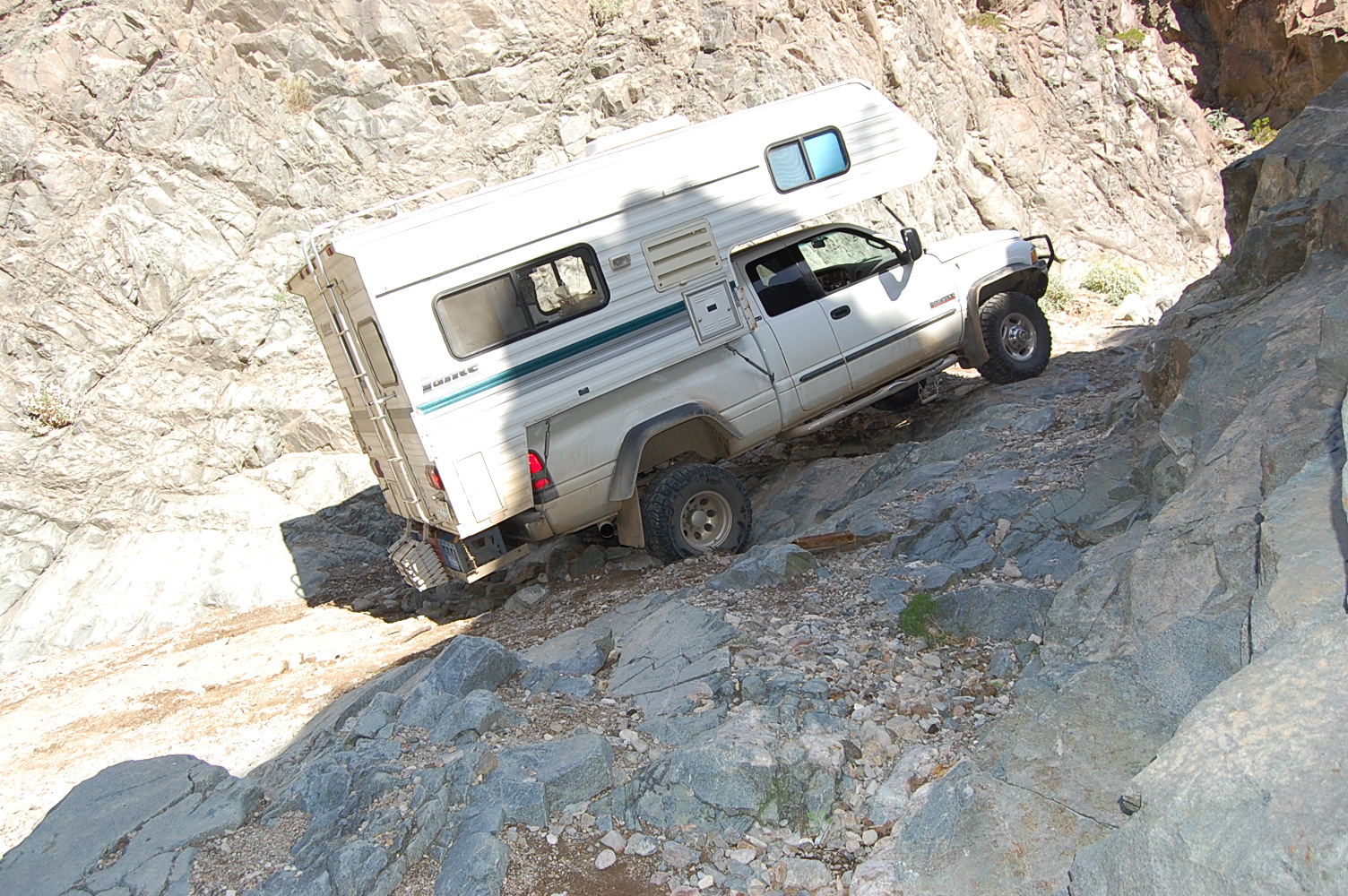

On a recent run through Goler Wash in Death Valley, I met my Waterloo trying to climb this waterfall:

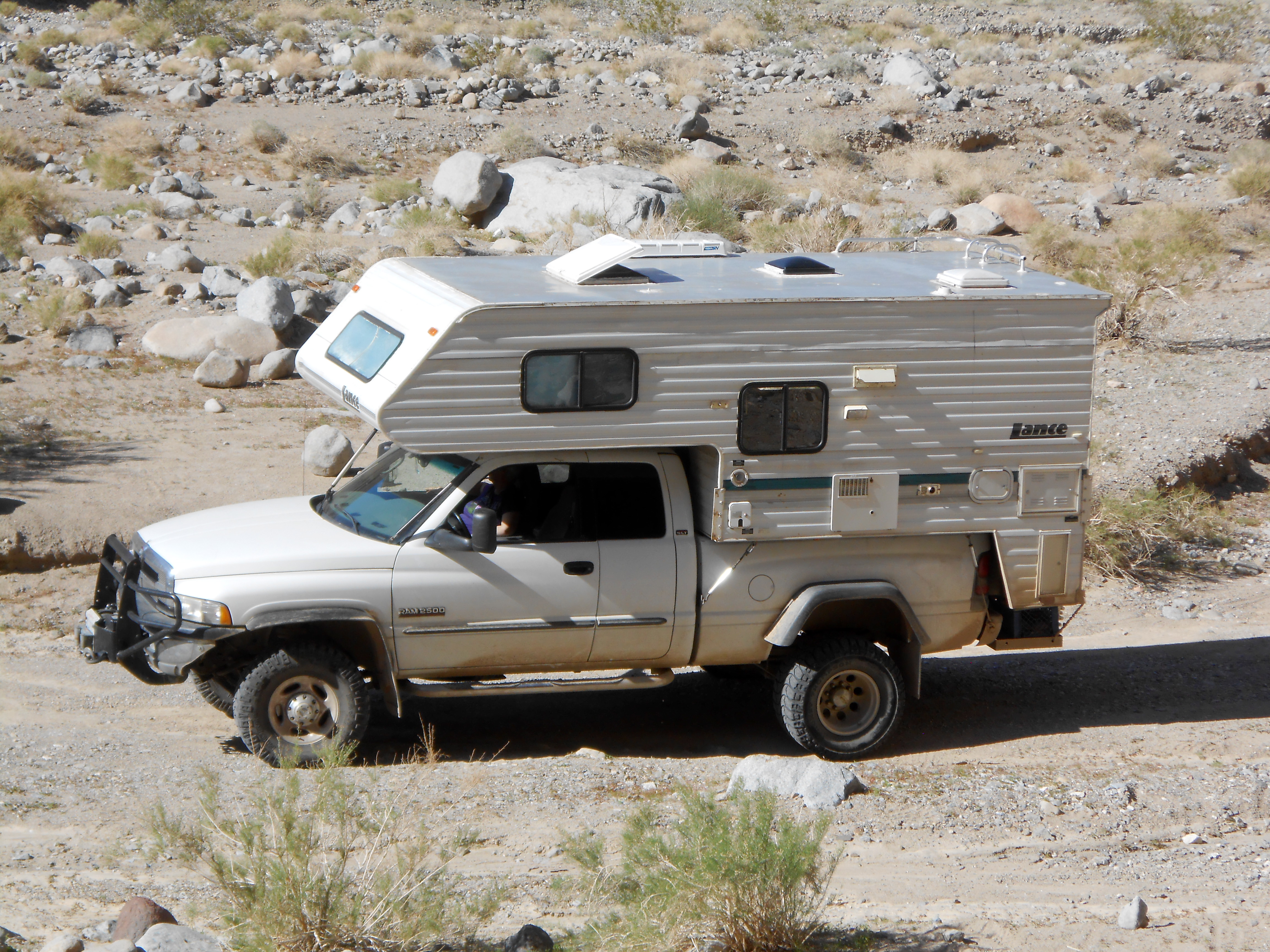

I have not been on in a few months. Since my special nitch is hauling a truck camper, here is the full on D-80 with super singles (duplex) that take the place of duals. In the pic are the 7" TJ fender flares and dually mud guards i cobbled on.

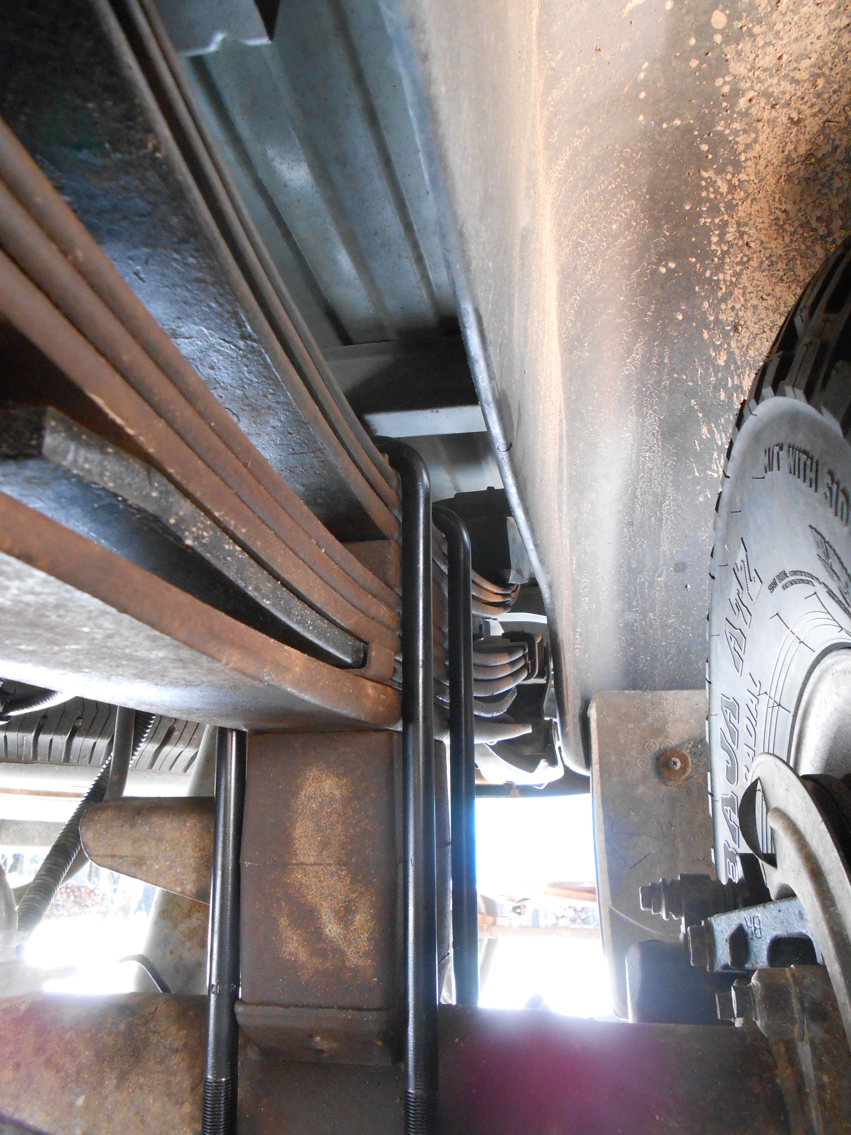

The perches on the axle that hold up the springs define the outside 'tilt' angle of a tall load in the bed. The Mickey Thompson E range wide tires have fairly stiff sidewalls to hold up the load. Much less squirm over all. I recently replaced all the grommets in the frnt/rr anti-sway bars. Better. (and upgraded virtually the entire front axle and steering components) I keep the heavy contents of my Camper down as low as I can. Nothing on the roof. So, the answer is: yes, a wider track helps with stability but it's not the only consideration. All the above aspects work together to give me what i think is almost no sway when going around tight corners at speed. And this is with a 3" lift, front and rear. The stock suspension is a compromise between 1. a good ride 2. able to hold up the load. Guess which one won out.

The upper pic has 8 leaves, Stable Loads on the ends (those black blocks), 3 leaves in the upper secondaries (overloads), one thicker lift spring in the pack. The Rancho 9K shocks are on the lowest setting with no load and the thicker single overload spring does much of the springing when the truck is empty. When loaded up (about 2700 pounds+, every bit of it loaded onto the rear axle; none on the front axle) the upper secondaries via the Stable Loads come into play incrementally,the shocks are on the stiffest setting and the load stays surprisingly stable.
This took some fiddling to get it right for my set up.
jefe
