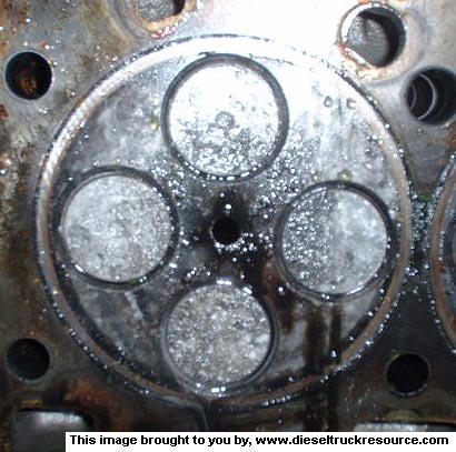

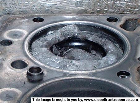

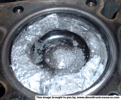

UPDATE
Here's what #6 looks like...
another...
and the head...
I'm still debating how much to invest in the rebuild... whether I just want to get it running again or build it up.
