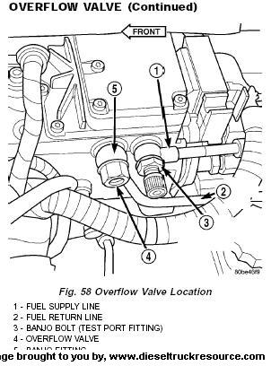

Where is the bypass valve located? I have never cleaned mine.
Yea if yall could point out to me where exactly that thing is i'd appreciate it, like Coachgrowl i aint ever cleaned it and would like to make that part of the maintenance chores

Sorry for the delay.... had to wait for the photo to be approved before I could post it.
It's #4 in the pic.... the FMS calls it an overflow valve.
