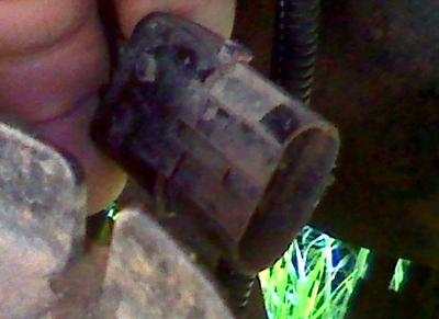

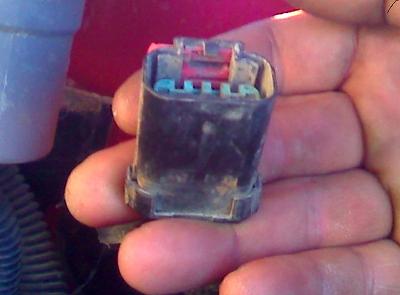

what are these for?

those plugs you showed in the picture were did they come from on the engine area. is one pulled off looks like you have it outside by the tire.
