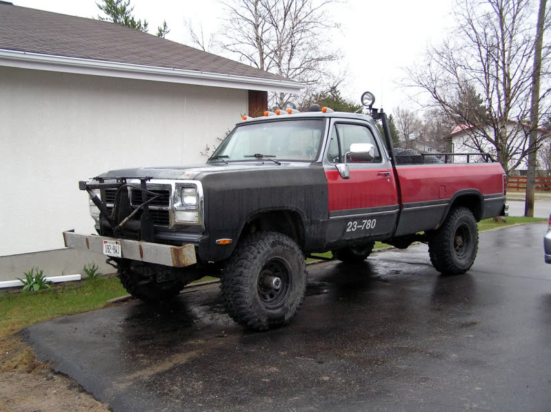

Plow truck? Yup, got one:
Blade is an 89 Boss 8'2" V, and was sold new attached to what was supposedly the 61st Cummins Dodge according to the PO of both trucks. The vin did end in 00061, so, it was entirely possible.

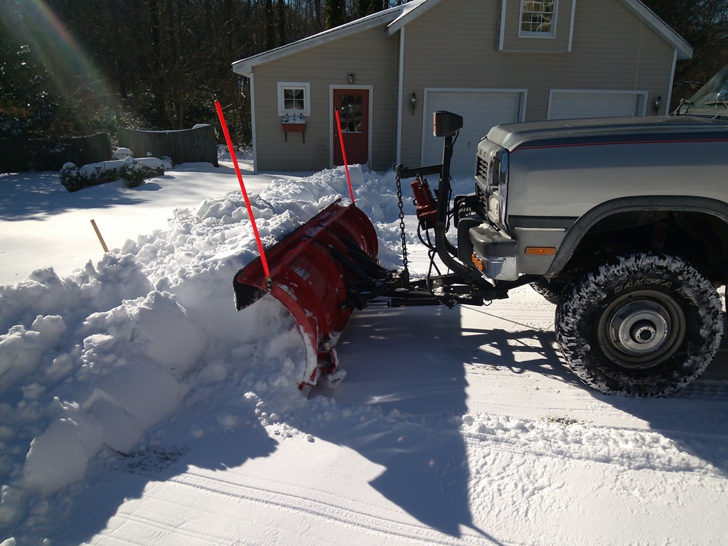

Well its been awhile since I posted anything on here so might as well update this...
Made some good progress this fall. Don't have any completed pictures but here it is painted!

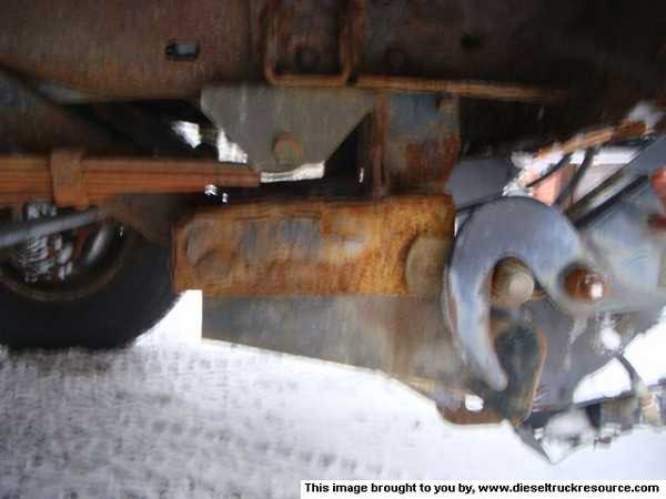

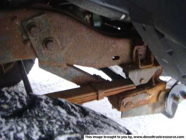

I have an Ultramount plow on my truck. I bought it because it seemed to leave the most clearance of any of the mounting systems with the plow removed. I bought a new 7.5' (I had my reasons, but they were bad) plow and got a used mount from a '90's Chevy -- pre '88 would have been better -- and fabricated the shoes for the receivers from it to the frame.
The unimount hangs down much lower than the ultramount, so I really think the way to go is cut most of the plow side away from your unimount, graft on some ultramount shoes (the parts the "receivers" pin into), and then buy an adapter Unimount Adapter to use your old unimount plow on the ultramount shoes . . .
And, yes, I am procrastinating at this very moment, instead of plowing the driveway . . .
EDIT:
Now that they are approved, a couple not very good pics:
I've been plowing non-commercially with this set up for 9 years, and it has held up well. FWIW, I painted the mount with POR-15 back then, too. Not all of it was blast clean, but you can see it didn't hold up in the long run.
