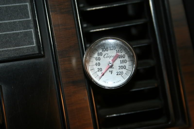

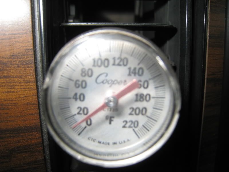

I would stay with the R-12, DICHLORODIFLUOROMETHANE.
That is what I have in mine and my register temps usually run around 20* but it has the ability to get much colder.

I'm very confused by Jim's temp ??? I thought sub-freezing would return liquid to the compressor which isn't compressible. Is that thermometer broken?
Does you evaporator freeze? If that's R-12, what's your low and high side pressures when you indicate 5 F??

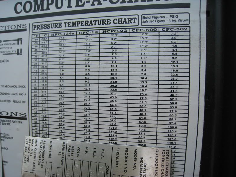

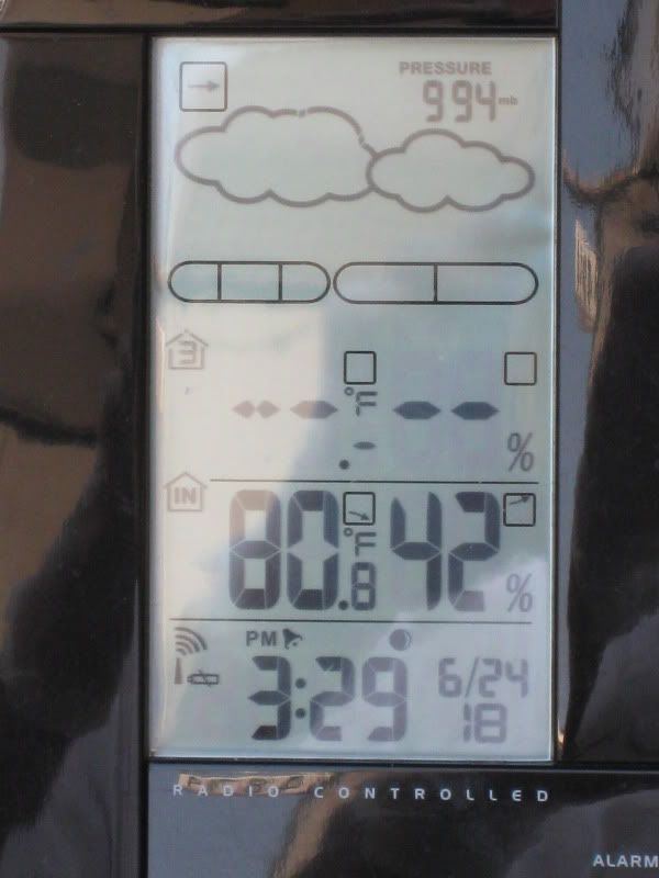

Here is a Pressure Temperature Chart this will tell what the pressures will be at any given temperature. See at 80* ambient temperature R-12 should be 84.2 PSIG

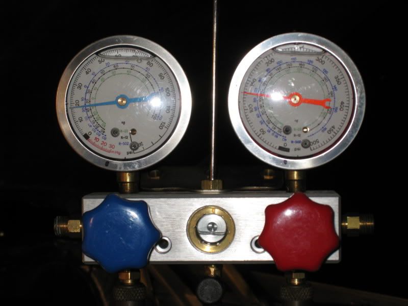

See what I have static.
Now here are my pressures @80* ambient with the evaporator blower on High and only the engine fan was the only ram air to the condenser.

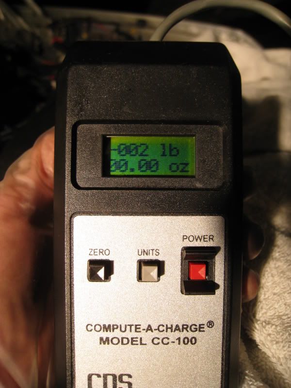

This is interesting, the factory charge should be 44 ounces of R-12, and I charged the system only until the sight glass cleared. It was charged at 2 pounds or 32.0 ounces.

Today it was probably 100* and after a couple of miles the inside vent temperature would only get down to 25* so I need to check and adjust the charge and see if I need a few more ounces.
M
What is confusing?
Freezers and Chill Plates will produce temperatures well below freezing and they still have gas returning to the compressor.
No my thermometer is not broken, I have several and they are all calibrated using the Ice Point Method, if you are not sure what that is check this.
http://www.myflorida.com/dbpr/hr/for...s/5030_062.pdf
Yes my evaporator has occasionally frozen up but that will usually only happen if I have the fan on low speed, it has done this maybe 5 or 6 times that I can remember.
Yes it is R-12 and I would have to go back and find the pictures from the last time I charged the system to see what the pressures were, but in the post above it would produce temps of 10* with about a 70 MPH ram air.
Also if you have read my post you will know that I have removed my Cycling Switch so I can control the compressor from not cycling off when it thinks it might ice up, I can push the system to its lowest possible temperatures. It seems that I control the ice up with a constant flow of air over the evaporator coils.
If I am on very long trips we will usually be wearing a jacket in the cab because it can get uncomfortably cold and I will take it off MAX A/C and temper the air with the heater.
I also find that I have to turn the side vents away from the steering wheel because they will freeze my knuckles as an added bonus I can direct the left hand vent onto my drink holder and I will always have an ice cold drink.
