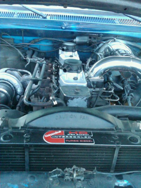

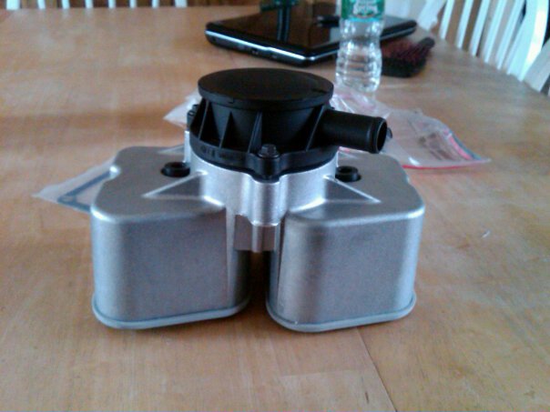

dual valve cover breather installed on ole shakey

From: Clearfield, Utah
Nice where did you get them. I have been thinking of getting some.

Pure diesel power not cheap might be able to get em from cummins cheaper I'm ordering a second one and polishing two of the old covers to match. Btw your sig pdp sells a longer screw
Yeah I saw those but it almost looked like the screw just had longer thread area. It looked like the pin was the same size up to the o-ring so it wouldn't go in any further just longer to get to easier. But I do like your valve covers I have seen those a few times and always wanted some.

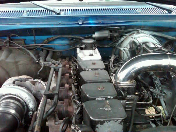

got em both on!!

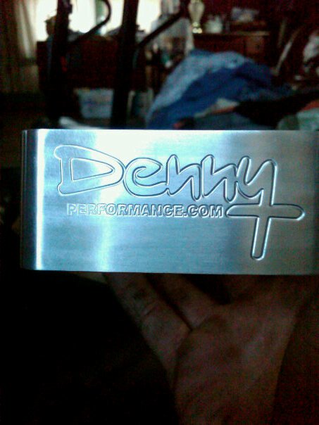

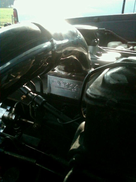

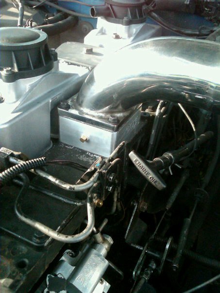

denny t grid delete
now i got 3 unused boost ports water/meth maybe.....
