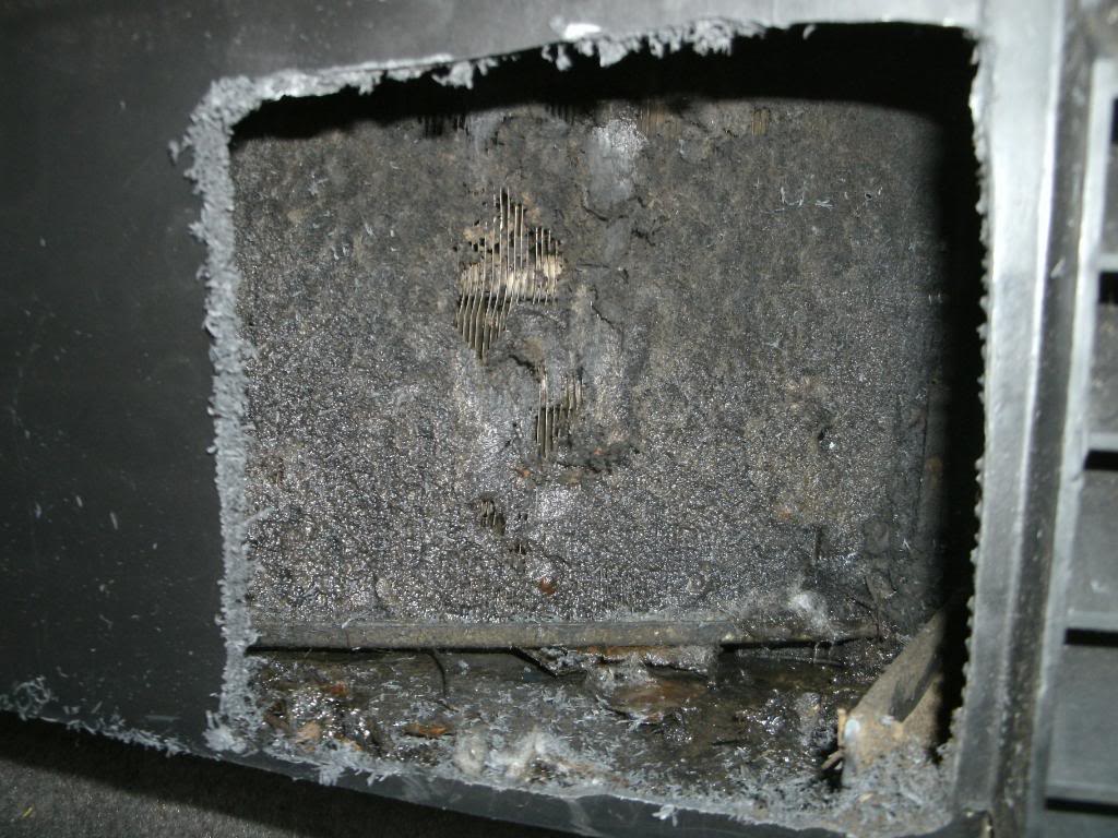

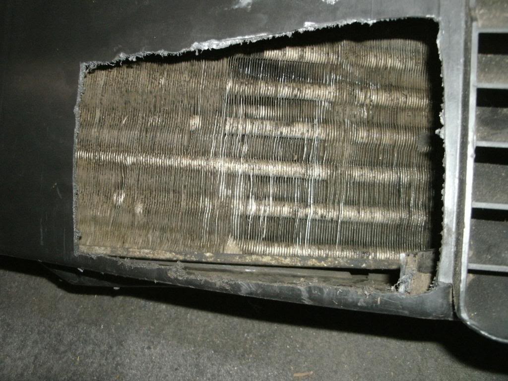

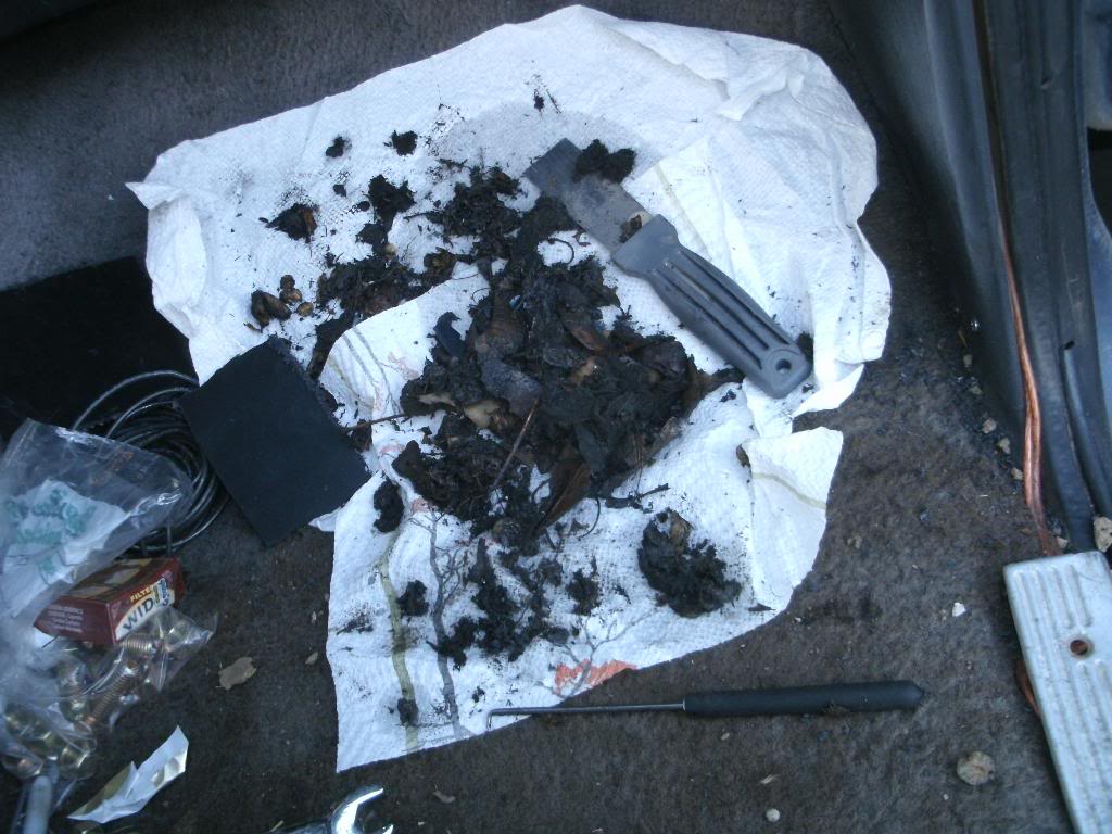

Well the AC works now, Had to cut a hole in the HVAC box the clean out the evap core, It now blows a lot harder out the vents and with the AC on it blow 44 degree air!!! Should be good enough for me. This will be weird I've never had a vehicle with working air.
Heres some pics of what it looked like.
