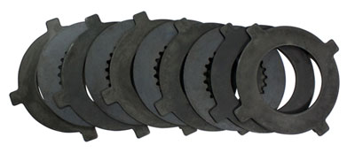

does anyone have pics showing the difference between good clutches an bad ones, tore mine apart today, not sure if I need to buy more or not.
Like this.

Those look nice, if that's the way there supposed to look I better replace mine , I have lots of wear patterens

The way I look at it is It is apart now. I really don't want to do it again if I don't have to.

Yes your right, on my way to east coast gears,
