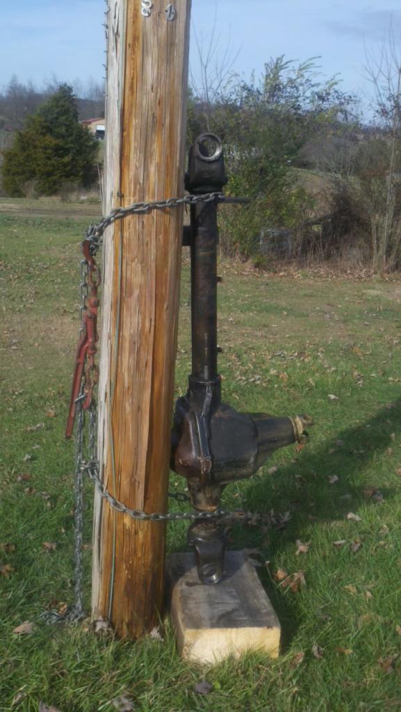

Got the bottom ones out like Mark instructed having a hard time holdin the axle to get the top ones out.
try heat and pb blaster, you may be dealing with a little rust....you'll get 'em...Mark
Old Nov 25, 2011 | 07:55 PM
maybe368's Avatar
Posts: 5,311
Likes: 566
From: Phoenix AZ
can you use another car or something to wedge it against a wall or something?...Mark
Old Nov 25, 2011 | 08:01 PM
rrfarm's Avatar
Joined: Apr 2011
Posts: 84
Gonna try somthn like that had one guy say he parked a ram charger on his to hold it.

Old Nov 26, 2011 | 01:55 PM
rrfarm's Avatar
Joined: Apr 2011
Posts: 84

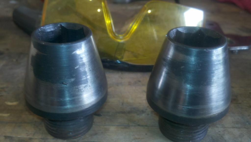

Here's a couple pics. Decided the kp's were questionable enough to go ahead and replace them. And the other pic is what i like to call a little redneck ingenuity and it worked like a charm. Everyone can feel free to use this perfected method at their leisure. This just goes to show there's more than one way to choke a dog besides on butter.
Ingenious, way to go. Those pins look bad to me, but what do I know anyway ...Mark
Old Nov 26, 2011 | 03:41 PM
rrfarm's Avatar
Joined: Apr 2011
Posts: 84
I the one learning so I would say im the one that don't know much I was about to let them slide til I started talking to you guys. Thanks a bunch maybe one of these days I can pass the along some info that might help somebody else.
Old Nov 26, 2011 | 05:10 PM
I love the tele pole trick.
I'm going to chain my wife to the pole out in front of my house the next time she give's me any backtalk..
That will teach her !
BTW,
What size is the allen wrench, or that special tool that you guys used in the "removal process ?
Would like to eventually do my KP's, and I don't think I have an allen that large.
T.

T, IIRC it's 7/8th" hex. Some guys just chop a hunk off of stock...Mark
