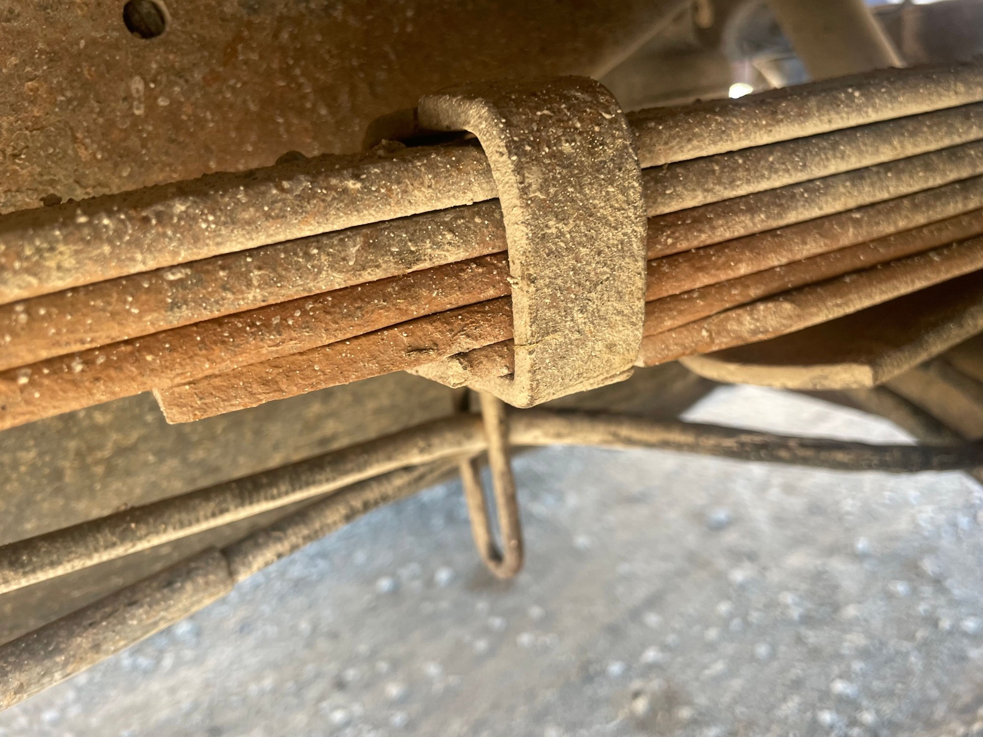

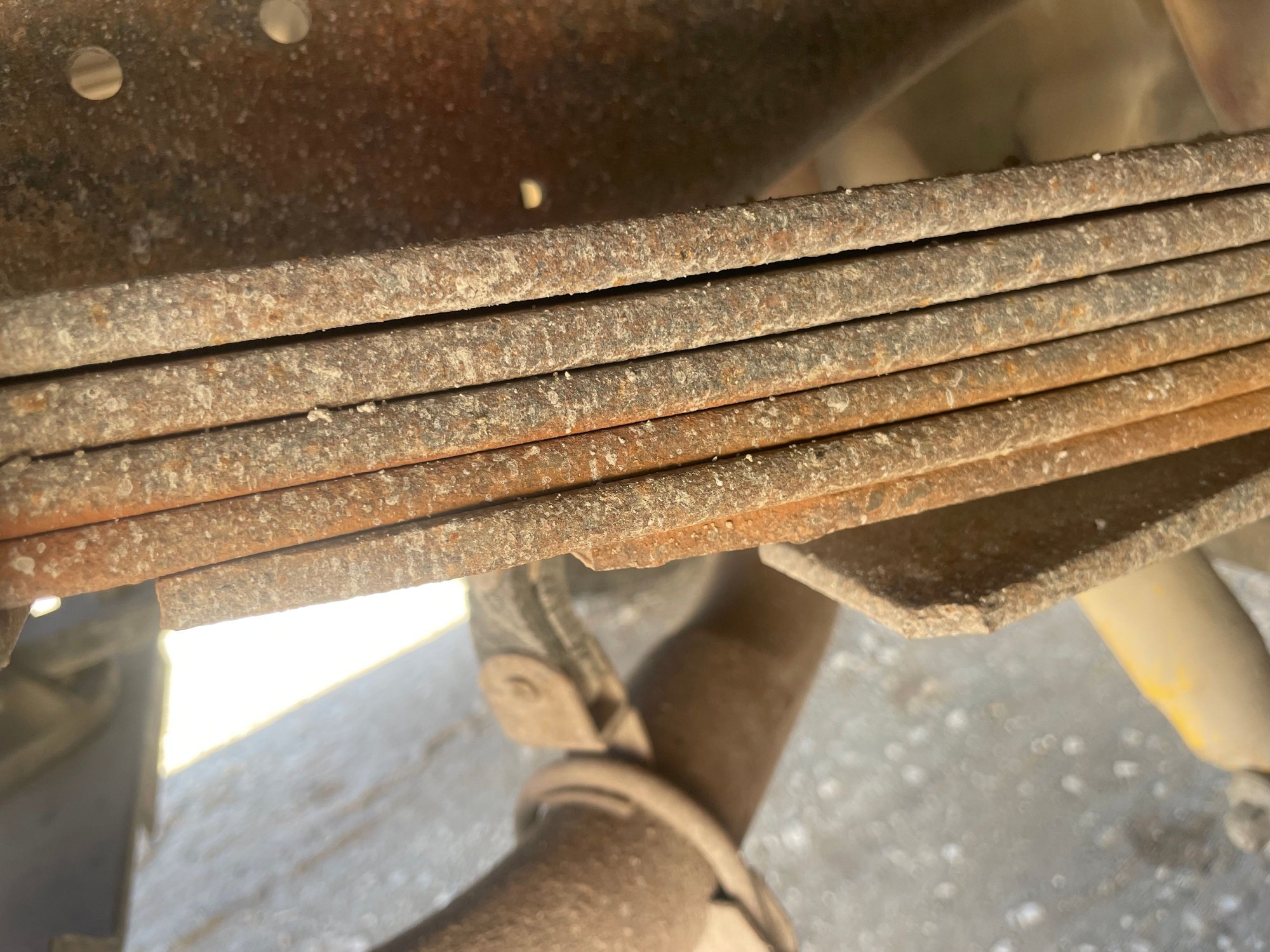

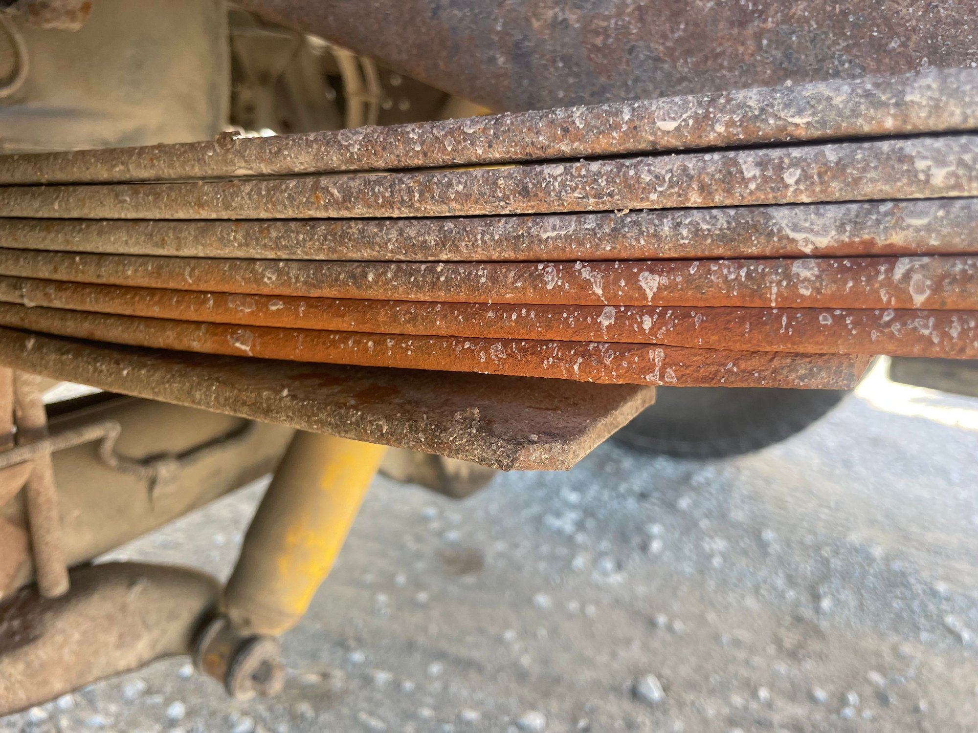

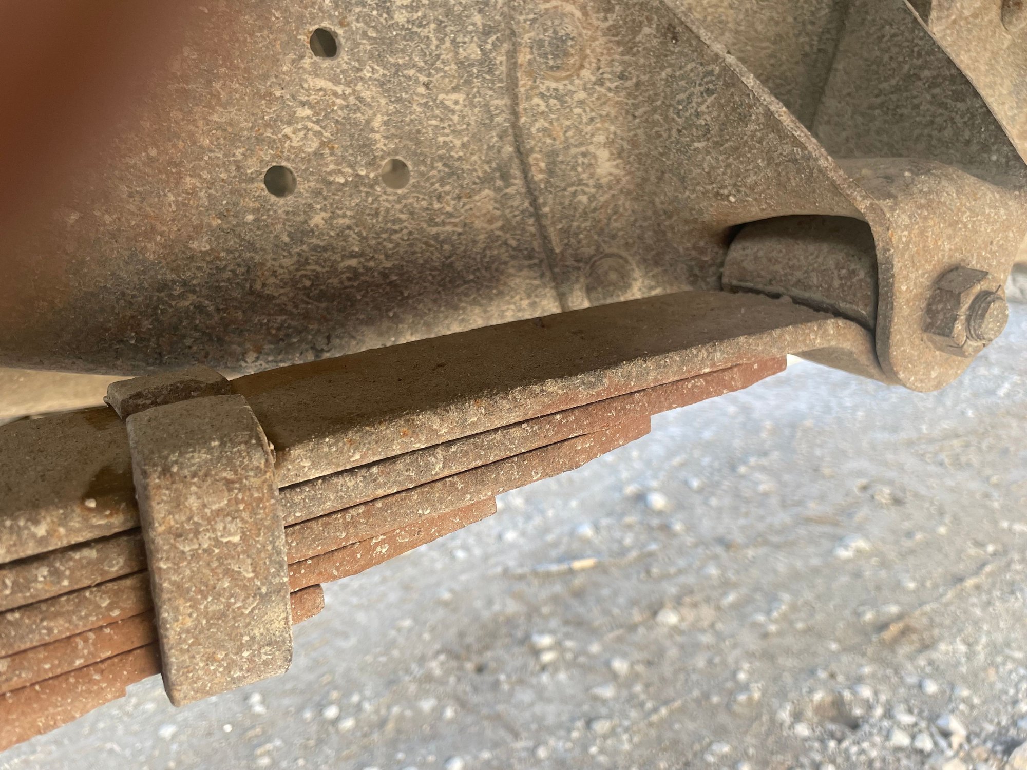

There’s some pictures I hooked it up to are bailer today and it was sitting completely flat on the overload springs so I’m assuming that maybe part of the issue the pictures above are with no load on the truck
Old Nov 12, 2025 | 01:44 PM
Posts: 7,221
Likes: 2,861

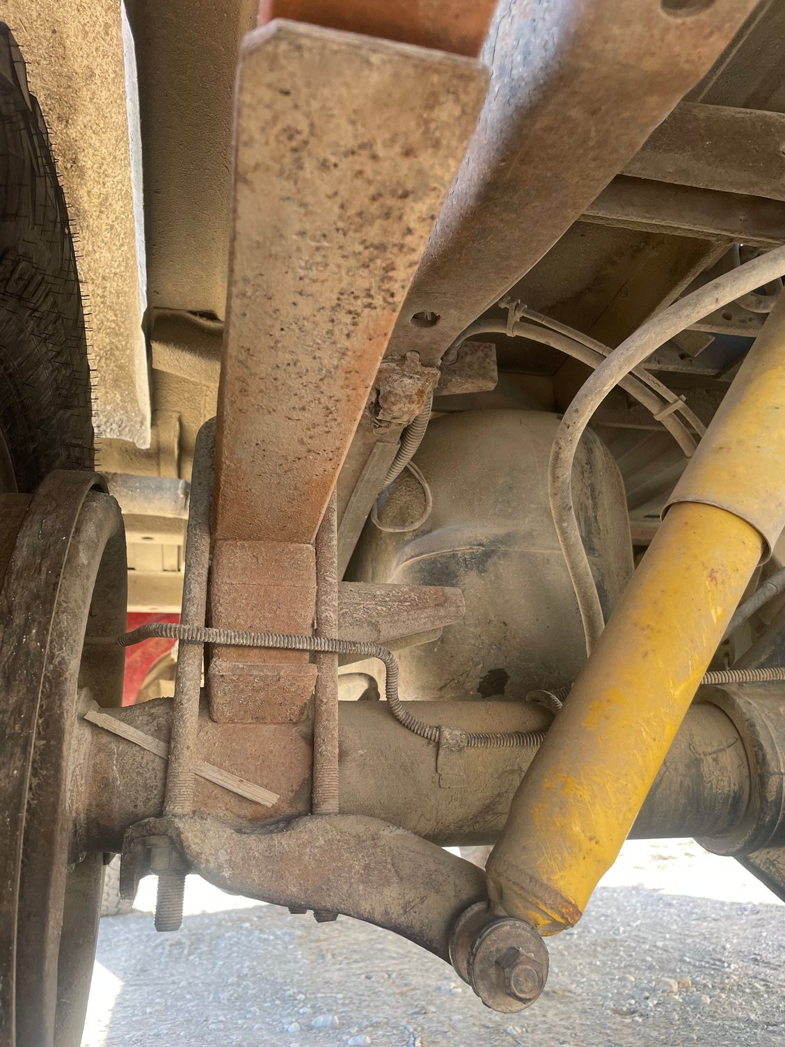

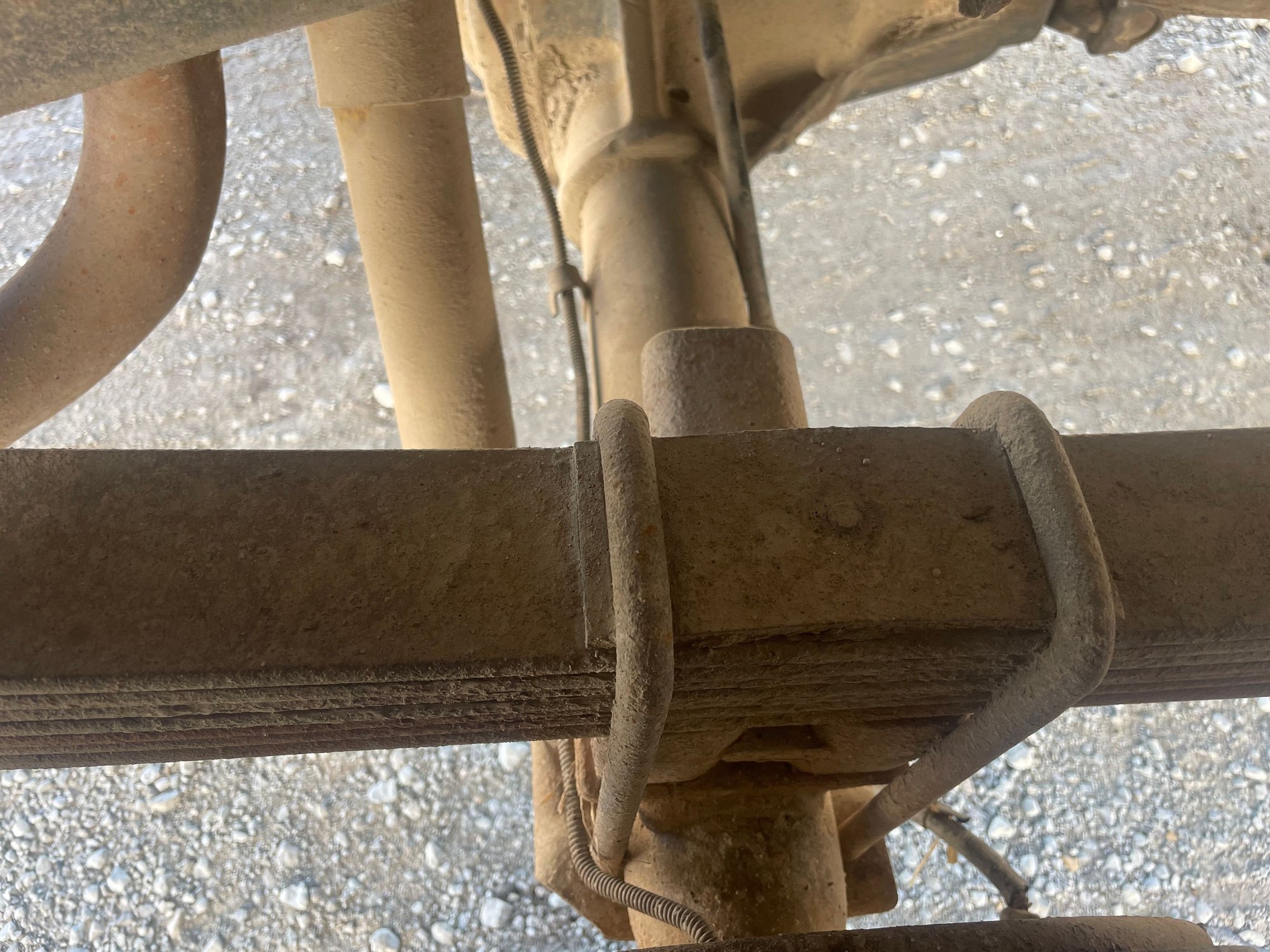

Okay. So we now have some good info to work with.
You have no camper springs at all, so the earlier comments from u2slow, nonrev and myself about the optional camper springs and their spacing can be ignored.
The set up looks very stock. It looks like it has the 3 inch rear blocks rather than the 6 inch blocks I see on all 4x4 '92/'93s, and some of the '91s which can have a mix of parts as it is an interchange year.

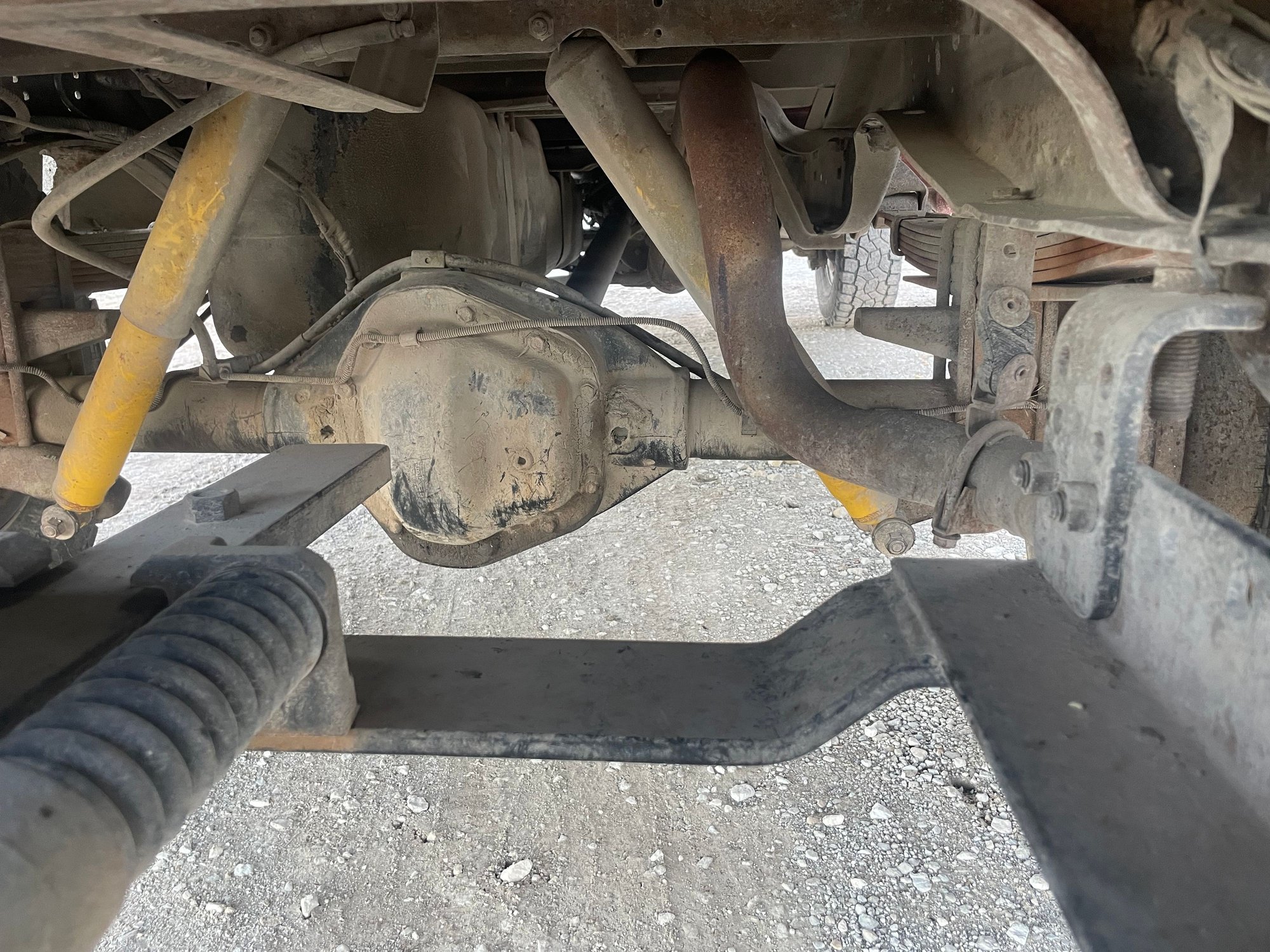

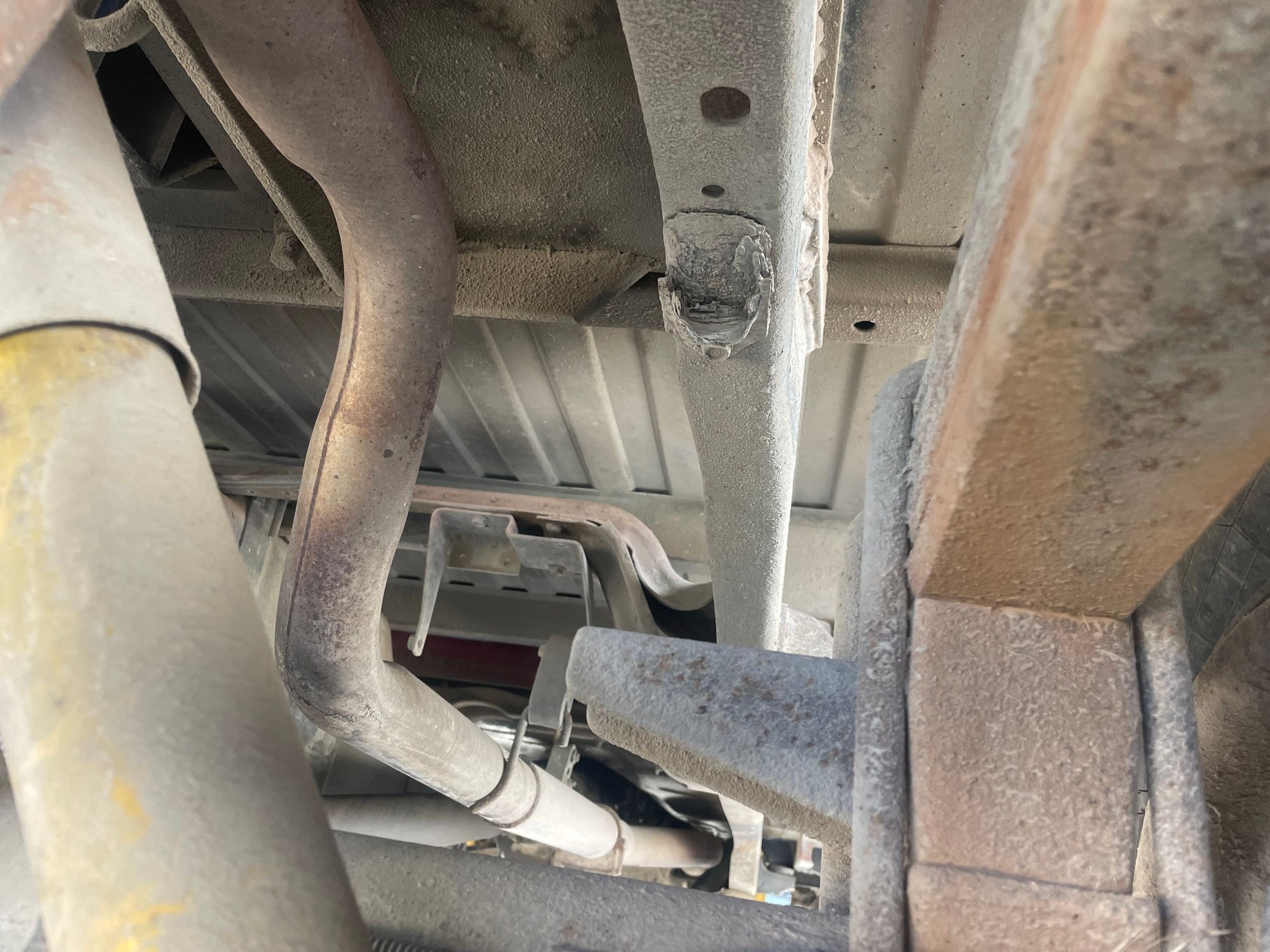

Interesting looking bracket hanging down where the factory would have the spare tire tucked away.
The bracket looks like it may have some shocks or something else mounted to it. Any other pictures of that as I do not believe I have never seen a set up like that before.
Maybe some sort of fancy tow hitch set up???
That is what the overloads on the bottom of the OEM spring pack are designed for.
To NOT touch when you are riding empty, unless going over a big bump, but to contact and add support when loaded heavy.

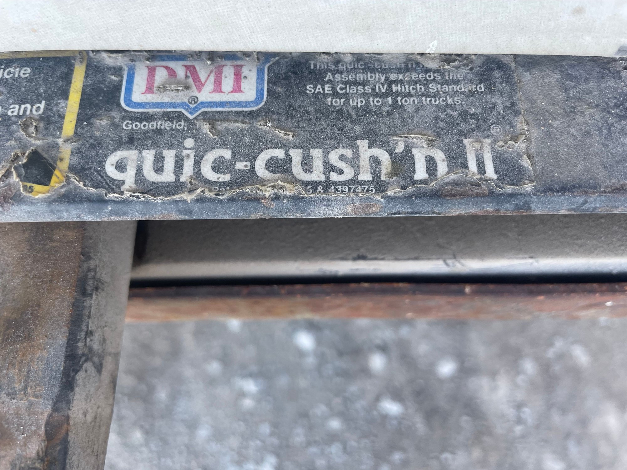

It’s a DMI bumper it’s got two big springs attached to the draw bar hitch so it gives it some flexibility to move around when you have a heavy load it was designed to pull hay wagons and anhydrous wagons which are heavy so the hitch gives some so when you take off or stop it doesn’t slam against your truck to hard

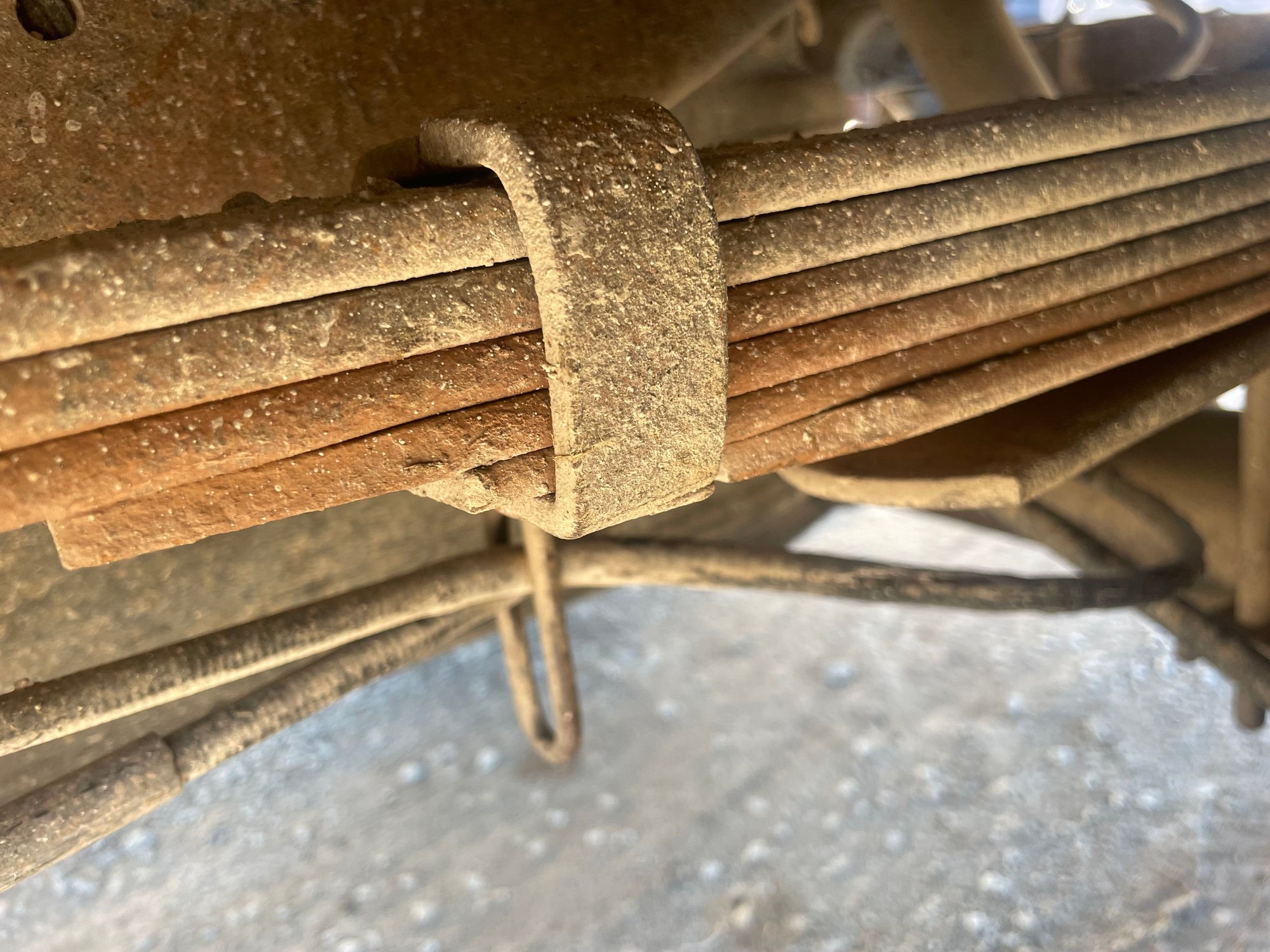

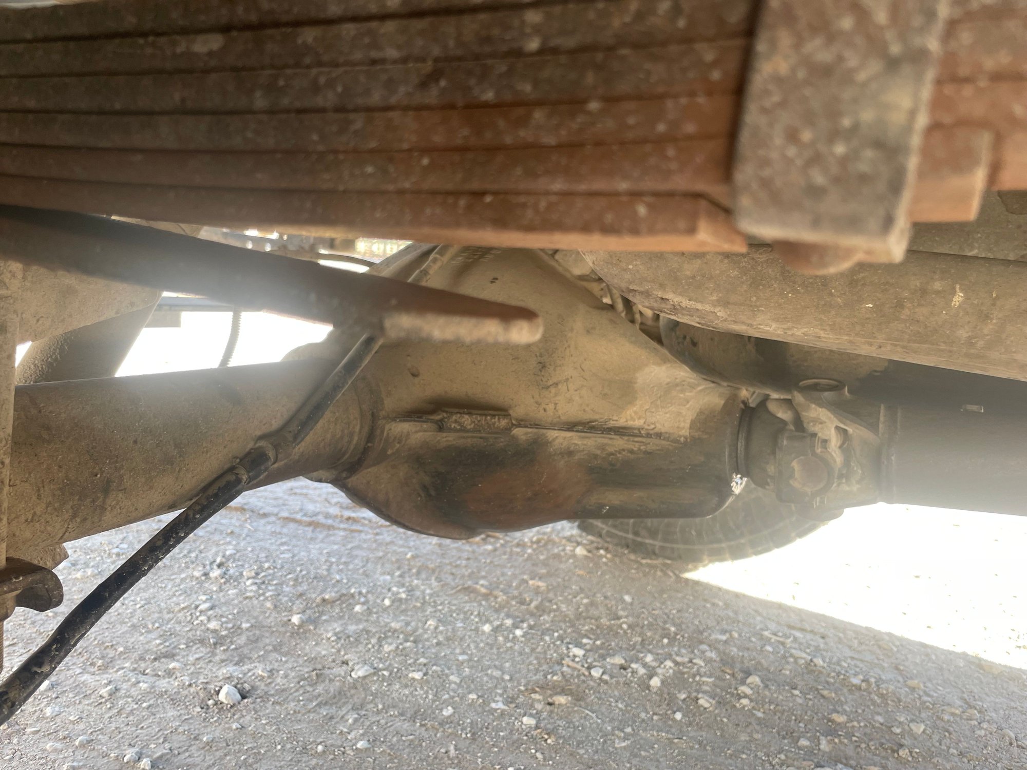

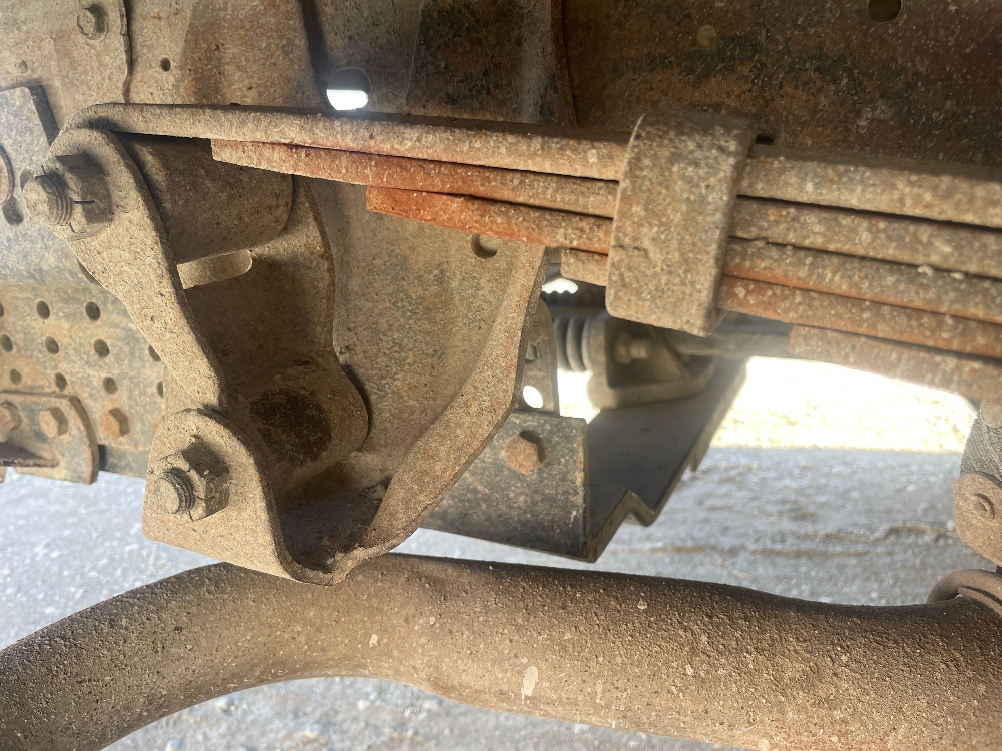

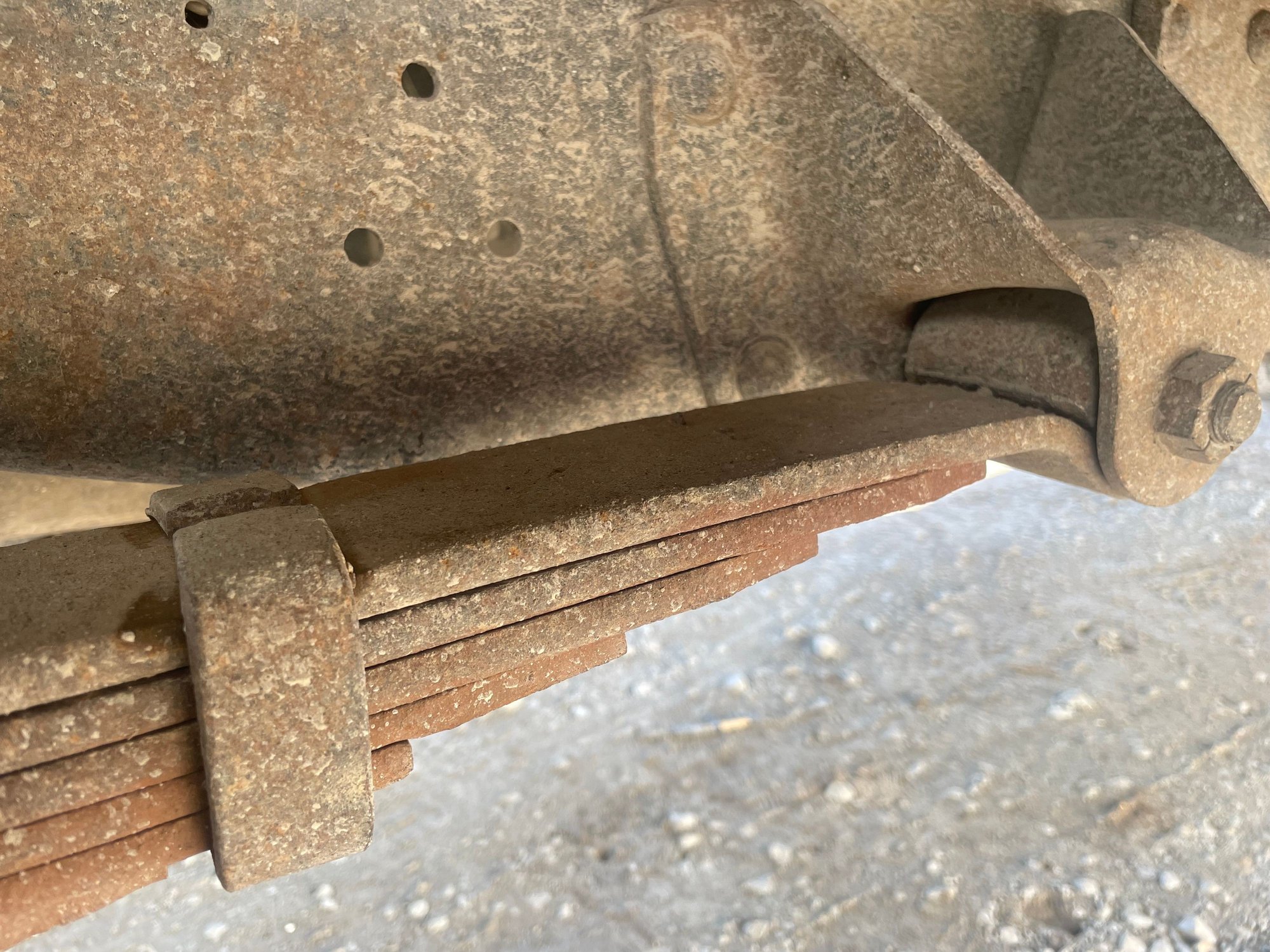

First pic shows the teflon style pucks that helps the springs slide easier and it worked pretty good on my application (snowplow truck with weight in bed) the second photo shows the rear of the front spring, if your springs have gone flat the spring will be touching or almost touching the frame, if that is the case a lot of people have used longer shackles to keep it from hitting frame and the bonus is it give you more caster which is a good thing on these trucks.
Old Nov 13, 2025 | 05:23 AM
Posts: 7,221
Likes: 2,861
Good point Vern,
If the front leaf spring is getting tired the shackle in the rear tends to hit the frame, limiting axle movement and making the ride extra harsh.
I have installed a 1/2 inch longer shackle on several trucks. One of them being the truck I call Poncho which I recommended the OP to check out my thread on my ‘91.0 on the 3rd post of this thread. I tweaked the suspension on that truck for a better ride in great detail. It would be a great read for someone who wants to improve their W-250's ride yet still have a capable truck to use when they need to,
