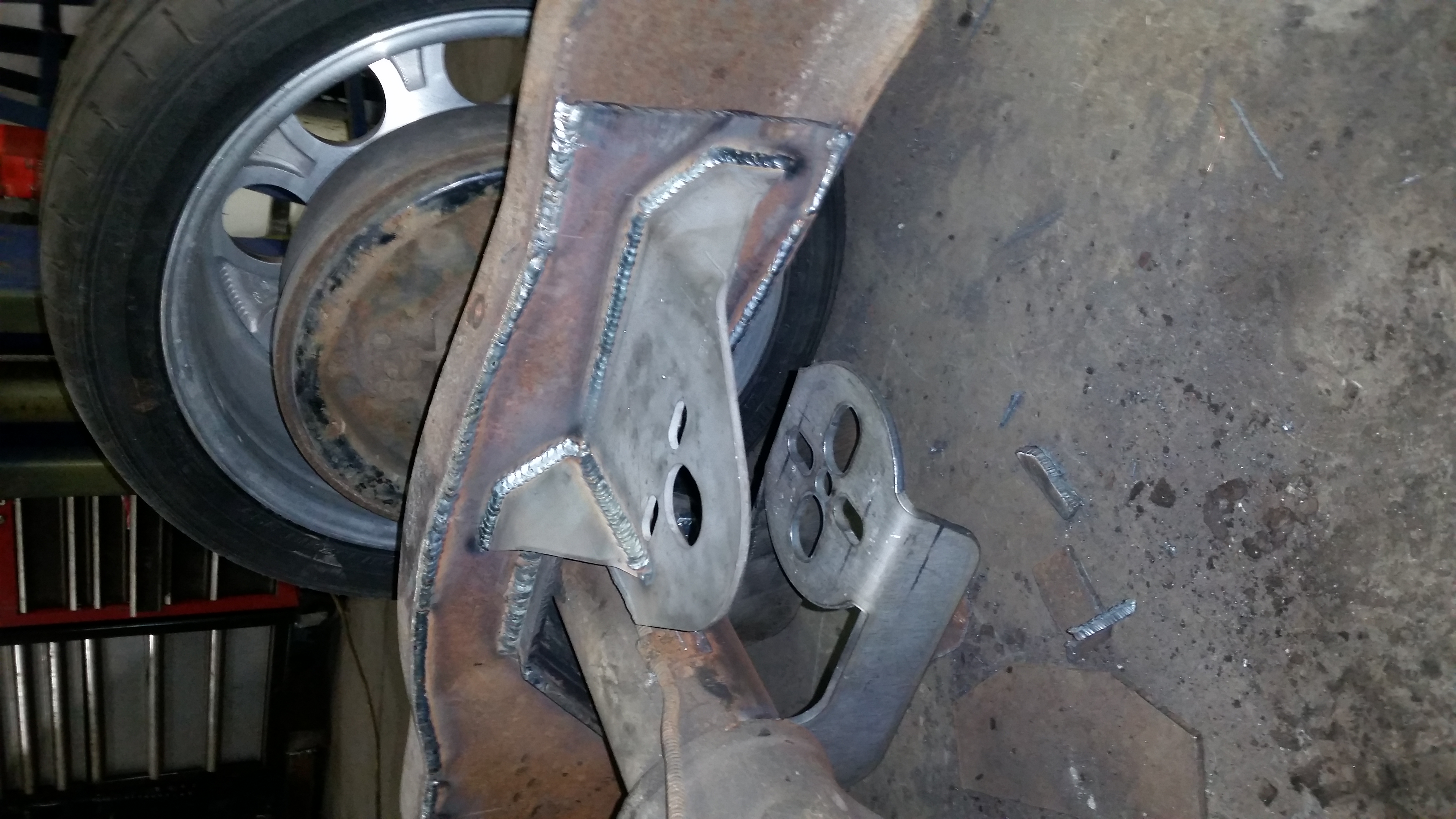

Check it out guys. Been busting out some work on this beast to get it low.
Attached Thumbnails How to lower your D250/D350-20160202_203430.jpg   How to lower your D250/D350-20160202_203453.jpg

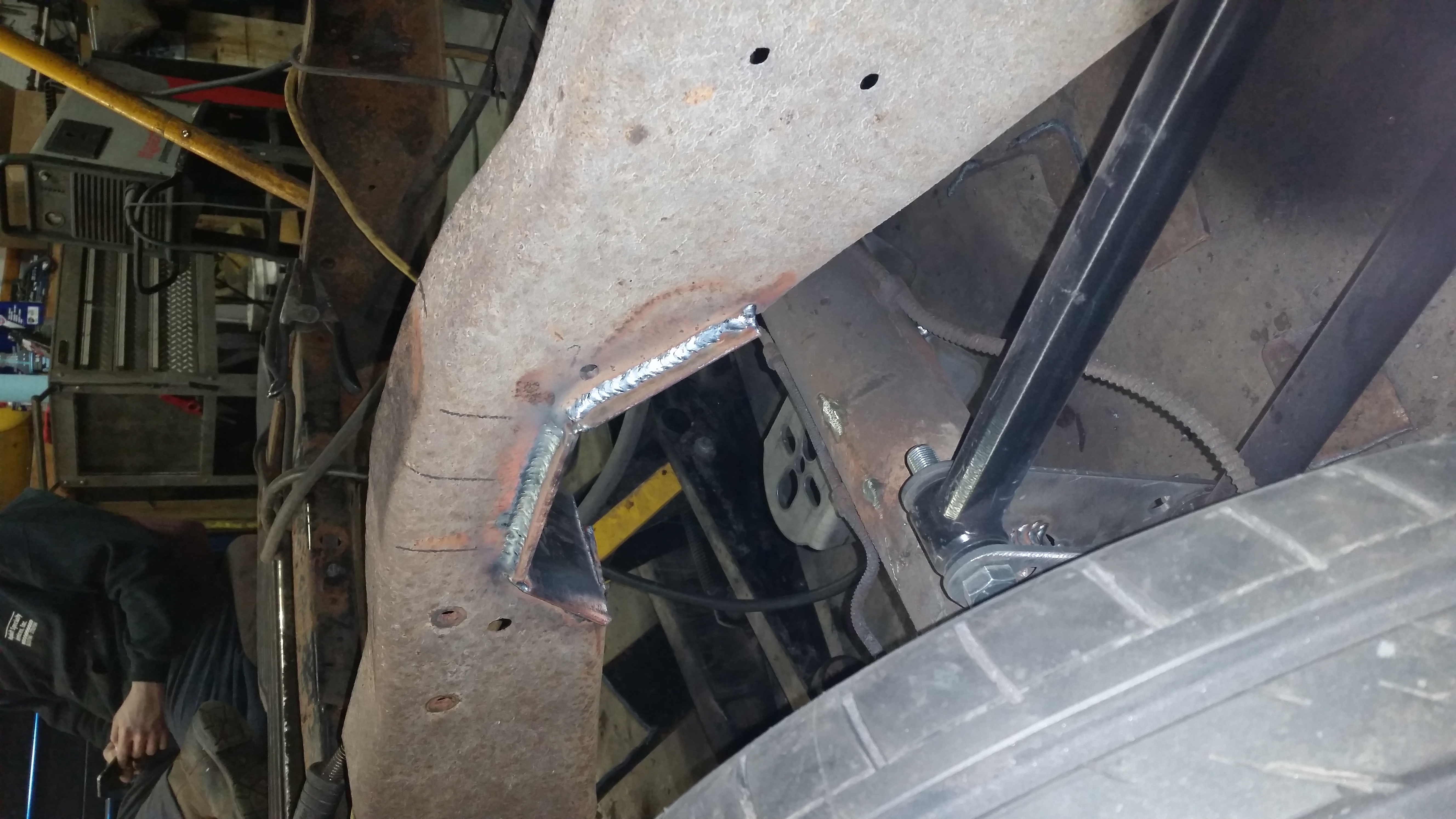

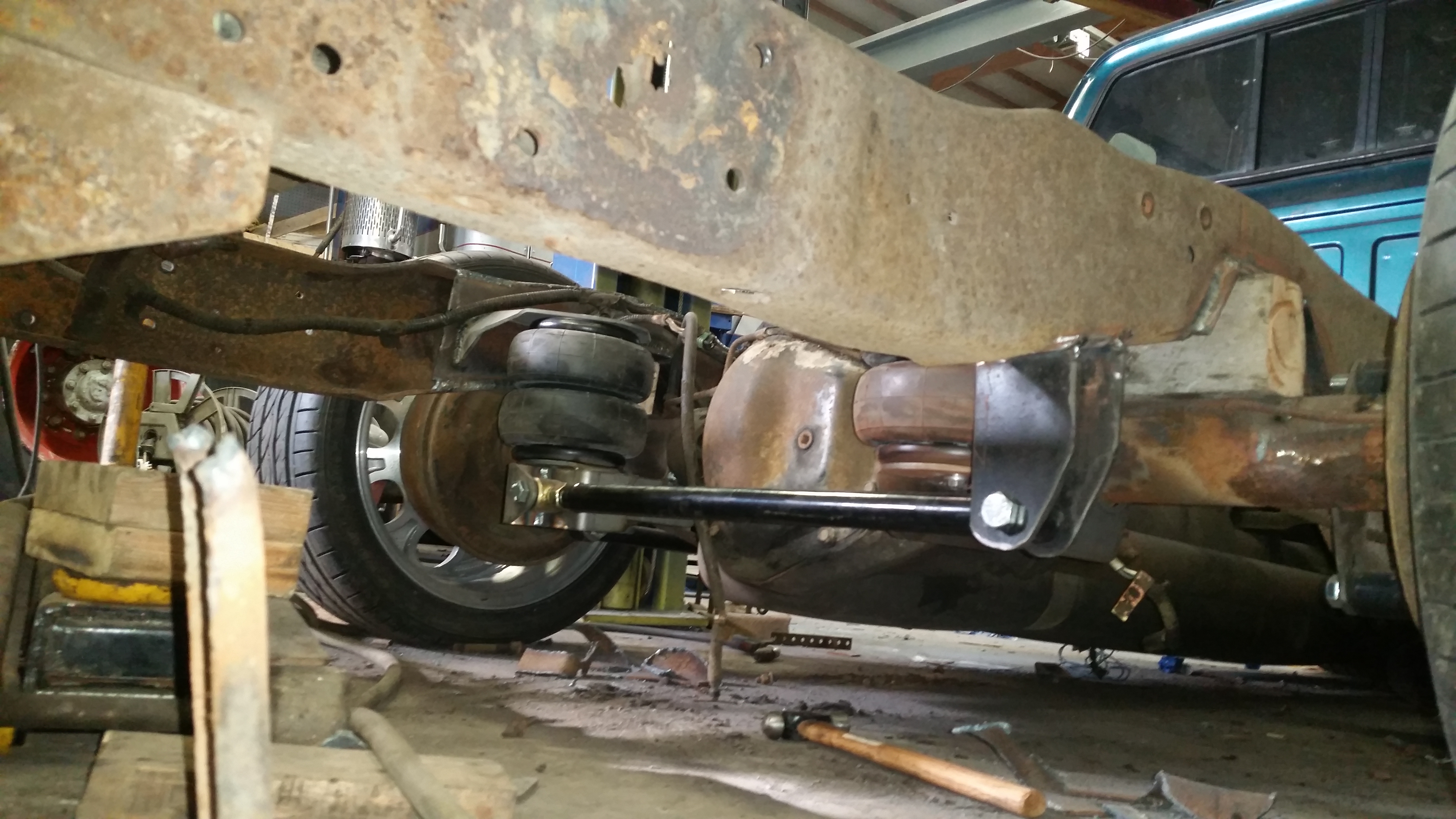

Nice, iv been wanting to bag my dually for some time now. Any pictures of your air ride setup.
Old Feb 3, 2016 | 12:11 PM
Babagnoosh's Avatar
Joined: Dec 2015
Posts: 15
Yeah check my gallery for more. Been alot of fab. I notched the frame in the back to get it on the ground. The truck does lay frame now. I made a couple blocks up front to protect the oil pan.

Good pics sir. It's looking real nice. What bags are you running front and rear. Did you make your 4 link and brackets or purchase them. If purchased i would like to know where. Your inspiring me very quickly

I'm running 2600HD bags front and rear. The 4 link is a weld on kit that I bought. Along with the brackets for the bags to mount to. However I did have to modify pretty much every bracket to make it work for my application. I did the frame notching myself along with boxing it in. I did have to make some brackets from scratch too for part of the 4 link. I went with the parallel 4 link instead of a triangular one because of how close the fuel tank is to the axle. I didn't wanna have to find a new fuel cell. Just gotta do some plumbing and wiring and a couple other button up things and she will be out ripping it up soon. I'll take more pics as I go for you guys.

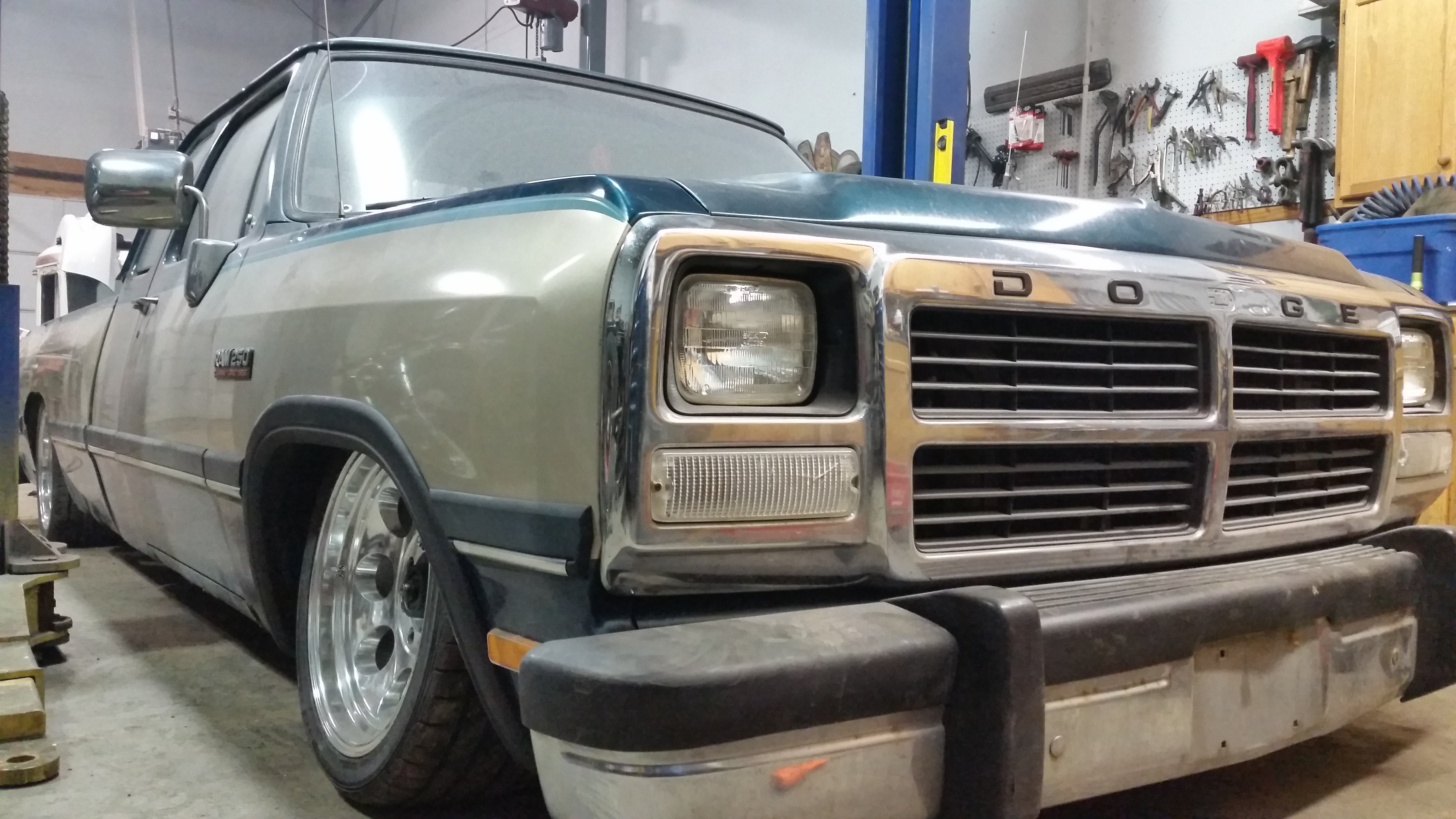

Babagnoosh's Avatar
Joined: Dec 2015
Posts: 15
Been driving the truck for the past couple days. So far I'm loving it. It gets a lot of looks and rides smooth if you get the air just right. Posted a couple pics one up one down.
