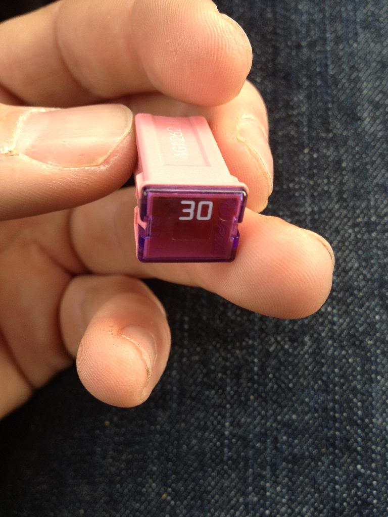

The +94 trucks use a square fusible link that plugs into the fuse box. They would be ideal to use as they are fusible links and easy to replace if something goes wrong. They are both colour coded and marked with amperage

No, I'm talking about fusible links. Since 94 dodge has used plug in fusible links like this:

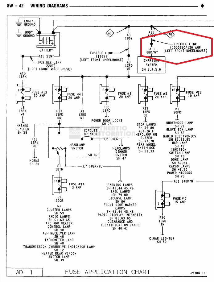

Originally Posted by j_martin
The fusible links are rated in amps, like fuses. The color is a code.
Use a Mega Fuse block and a 175 amp mega fuse for the green one.
Hey J.
I'm a little confused. Why do you recommend a 175 amp fuse for the green wire to the alternator, when the FSM says it's a 120Amp fusable link ?
Wouldn't it be recommended to use a 120 ? or is there a buffer requirement ?

Here's what my FSM says about the color chart, and size of the fusable link, but it doesn't mention amperages like the other diagram does.
The Wiring diagram here doesn't clearly spell out the amperages like you have them.
