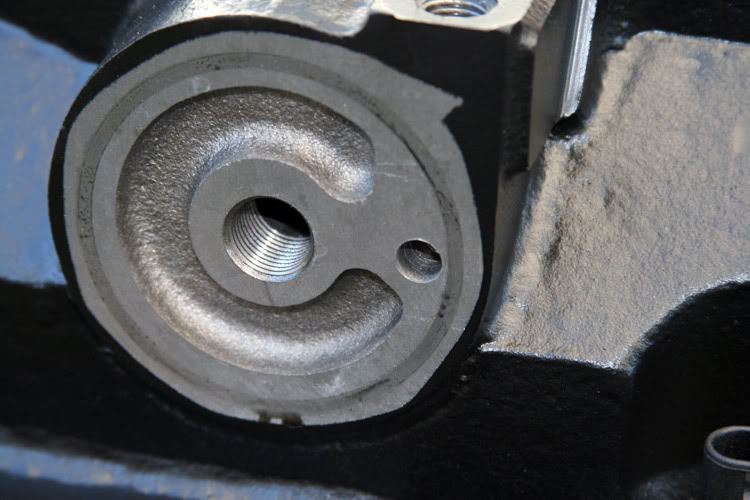

- Remove the fuel filter and take a big, wide blade something; screwdriver, chisel, etc. and unscrew the threaded pipe that the filter screws onto.
That will let the fuel heater fall away from the head. Time and use of the engine has had the rubber "Square-Cut" O-ring degrade (a common thing with the older trucks).

Replace that square-cut O-ring and you'll be good to go.
Be sure to wipe clean the surface of the head as well (see the footprint of the square-cut O-ring).

The threaded insert on that holds my fuel heater on used a 5/16 allen wrench to remove. Counter clockwise to loosen. Thanks again for the pictures on this. Really helped out.
