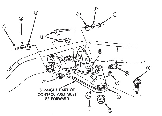

There is a bumper on the upper A that limits the downward stroke of the suspension. If that is in place and in good shape, you are installing the wrong shocks or are stacking the bushings wrong. The shocks are not supposed to limit the suspension travel. It is item 11 in the diagram.
