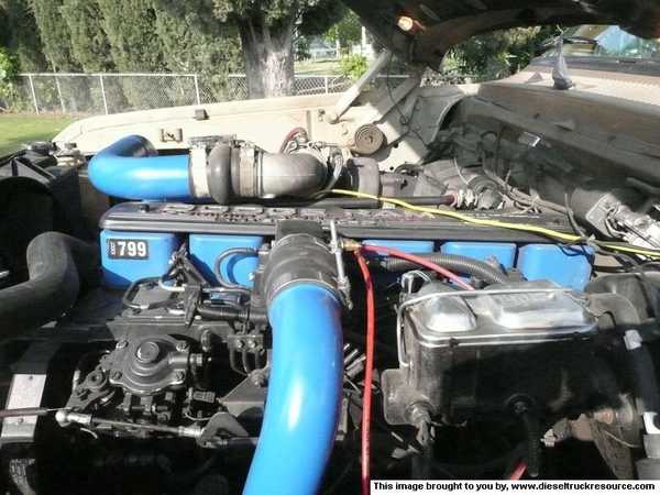

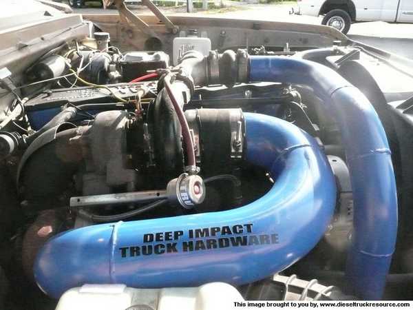

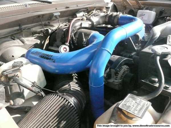

Talking twins finished!!!!
my dad and i finaly finished biulding the twins let me know what ya think!

Sweet! How does it spool?

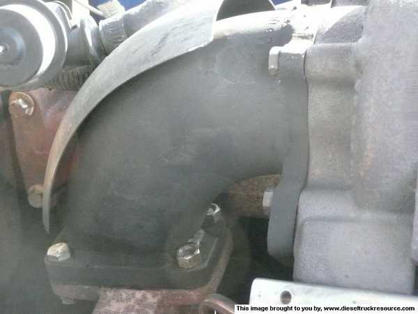

What is that bottom turbo? I would love to see a picture of how you got the downpipe out of there! All I can say is that Ilikebikes has set off some sort of chain reaction with his thread....

Just goes to show you that you don't need a $4000 twin turbo kit, just make your own.

well it spools crazy fast but it kinda falls on its face at high rpms the top turbo is an h1c with a 12 cm ex.housing and the bottom turbo is a hx 35 hybrid with a 21 cm housing havint got any vids yet but in third gear i can romp on it and go side ways now and chirp them in fouth we were just experimenting so i found a new bottom turbo off of a cat 815 compactor hope fully it will push more air but this set up atleast cooled my exaust alot

ill try and get a pic for you
