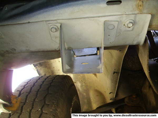

On our 91 there is a factory scoop thing under the truck in the front of the pass. side wheel well.well we wanted more air to our swiss cheese box so we cut a hole above the scoop into the wheel well to bring outside air up and around the box.
here is the scoop from underneath with the hole already cut out on top

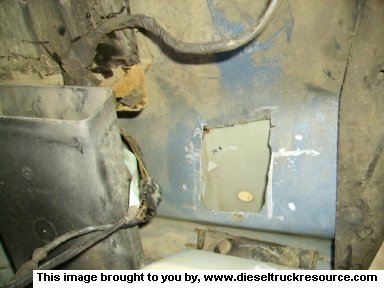

here is it from the top in the engine compartment
this is it when it was all done you can see the scoop right below the air hose thing

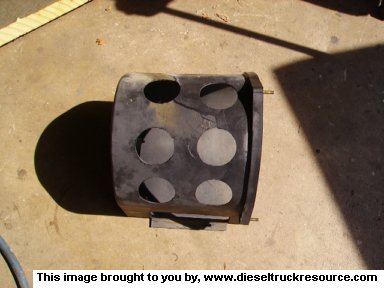

and heres our airbox that still looks stock and will definely pass inspection

your best bet would be to cover the air box to stop all the engine heat from getting sucked in.. hot air = less power. directing cold air in is a good idea
