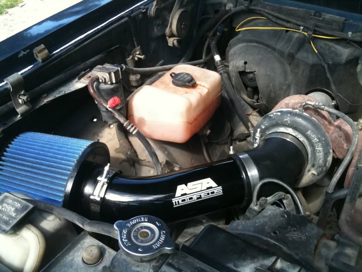

Old Jul 24, 2010 | 11:39 AM
Dodge_first_gen's Avatar
Joined: May 2009
Posts: 14
i just put my ASA intake on
Old Jul 24, 2010 | 02:12 PM
Crossy's son's Avatar
There's no shield or anything?
Old Jul 24, 2010 | 02:18 PM
The_Head's Avatar
Posts: 1,539
From: Wyo
No there isn't.
Old Jul 24, 2010 | 07:20 PM
blackfordd's Avatar
Joined: Jun 2009
Posts: 495
From: Torrance, CA
No shield. But you can hear your turbo a whole lot better now huh "dodgefirst gen". Couple more pounds of boost too.
