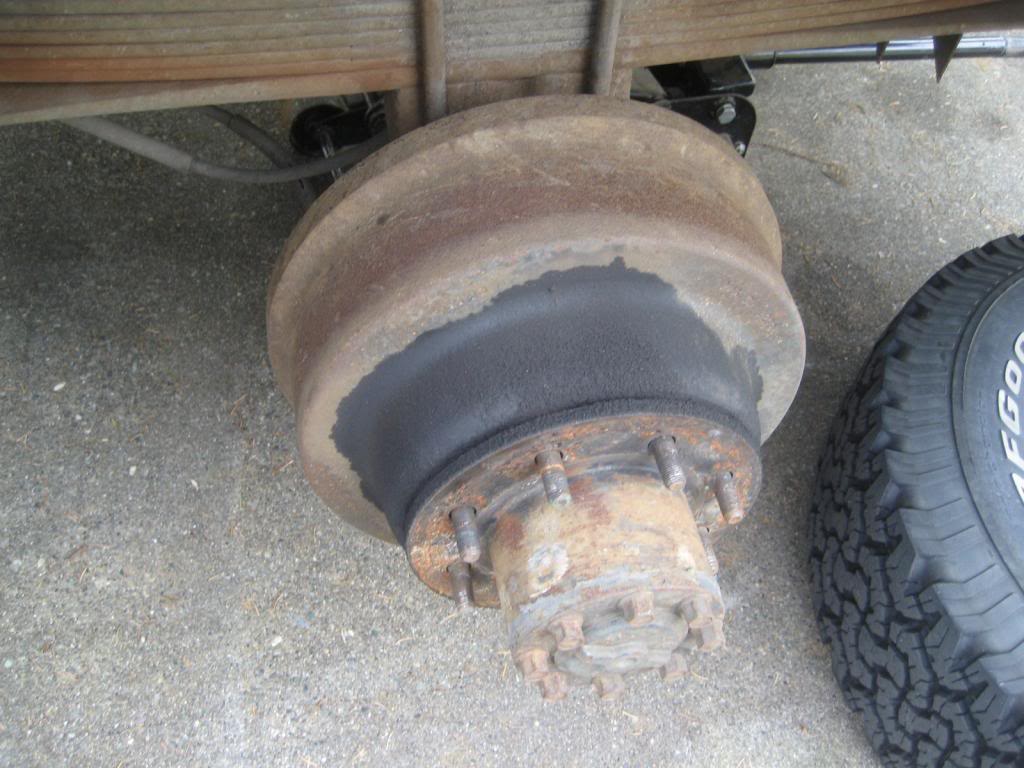

I'll bet that is gear oil on your passenger drum. Leaky seal or scored spindle, or if really unlucky, a cracked hub.
Spindle cure is in the sticky.
Might as well do it right now. Like was said, wheel cylinders are cheap and new brake line is easy to bend. Can buy factory stuff from places like inline tubing and classic tubing but kaching$$$
It certainly could snowball if your nylock nut retainer came loose and destroyed the bearings....
It would take just a morning or afternoon to fix all this...
yes, it would take just a morning or afternoon to fix it, if i knew whcih seal was leaking or that i was or was not going to need bearings.
if i take it all apart and find out "oh wow, the hub is cracked" well then it is probably going to take much longer than just one morning, depending on parts availability and such.
so yeah, perfect world, all it is is one bad seal? so i get some gear oil, RTV, a seal, and a couple wheel cylinders and go to town. but my workld is never perfect.
plus i would rather just wait, and take it apart once.
