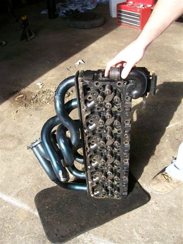

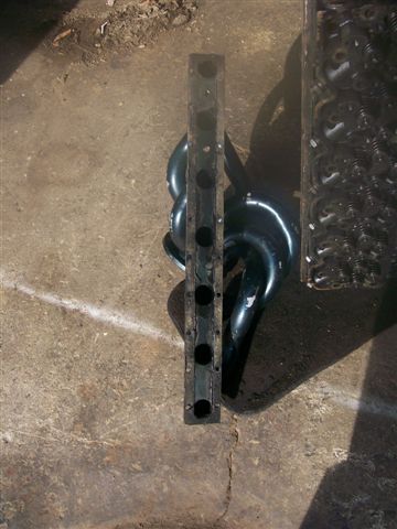

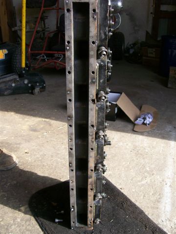

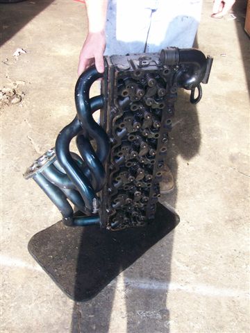

intake
we had this on a 24valve killed the bottomend seemed to really show up top
Attached Thumbnails Air Flow theory - Pressurized-000_0019.jpg   Air Flow theory - Pressurized-000_0018.jpg   Air Flow theory - Pressurized-000_0017.jpg   Air Flow theory - Pressurized-000_0016.jpg
