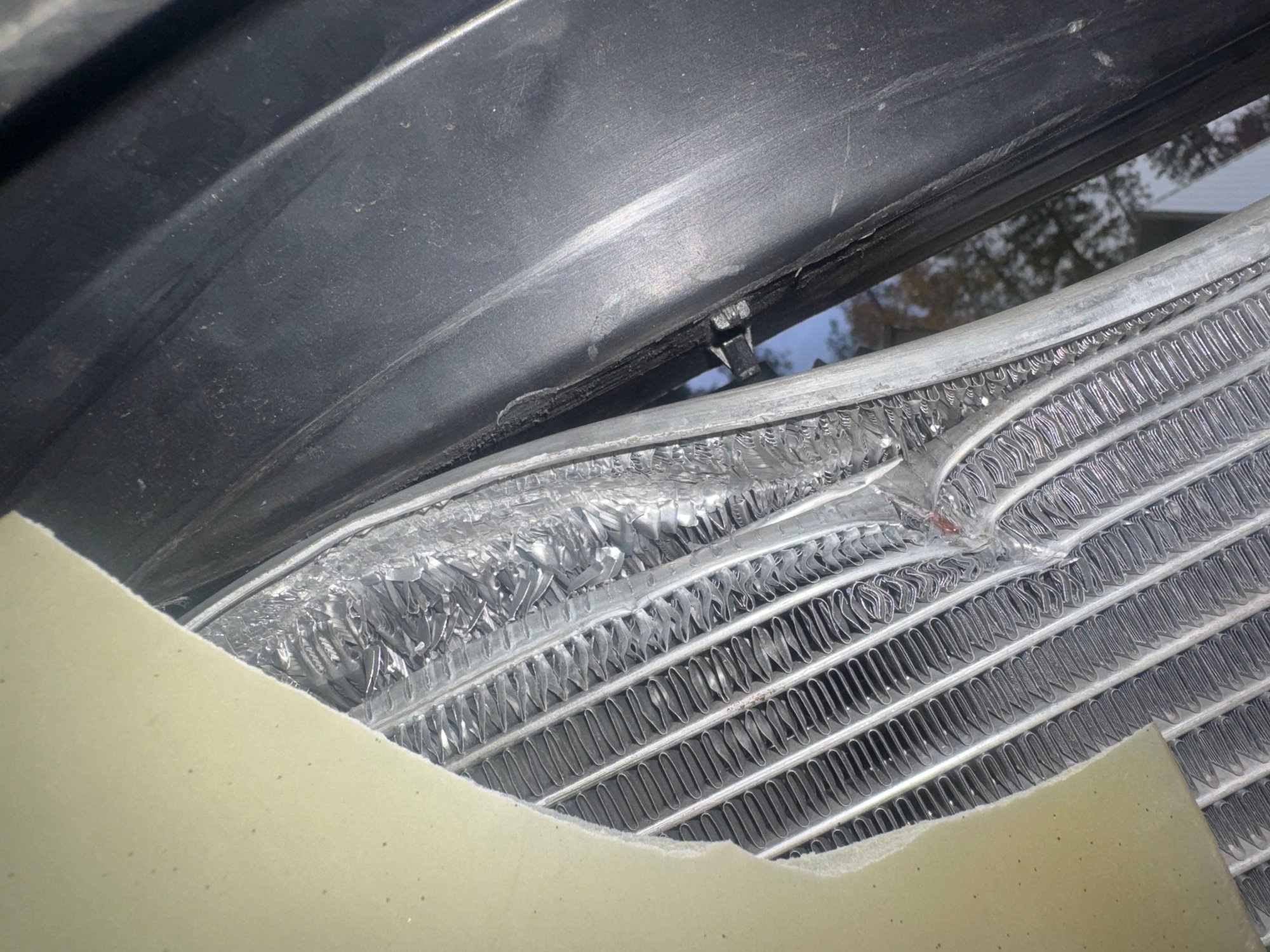

Had the engine running today, bleeding brakes and steering. Revved the engine a little.
Apparently my radiator fan was positioned too close to the radiator. Am hoping it can be salvaged by blocking off a couple of the cores that got damaged.
Annoying at this stage though, as I’ll have to go back and re-modify. May not be so bad, as I think somehow it was just the top of the rad that got pushed towards the fan, causing this issue, the bottom has more clearance then the top. May have a little room to move the cab and rad support forward, then just fix the angle of the rad to bring the top away

Yep, I understood what you said. In my mind, being that the engine mounts would be the pivot point in this situation, lowering or lifting the transmission will do what you say, and I see your sense, however it will also raise or lower the fan some as well, like a teeter tooter. The shroud around the circumference of the fan has a very small 1/4” gap, if I pivot the engine to change the angle of the fan, it will also move the fan up a bit, which won’t work.
Had a better look at things, and found an easy way to remedy. When I designed it I made a large enough gap, but somewhere along the lines when finishing the front rad support, the upper removable section started pushing the top of the rad towards the engine. Just need to modify the top removable section, to come out a touch.
Got the rad out today, will bring it down to a shop and see if it can be salvaged. Not too optimistic, but maybe someone can work some magic.

Good news, rad shop was able to fix the rad. They had to cut one tube out and seal, and the other two were able to be patched. Found a cheap used fan too. All in all, could have been worse.

Glad they were able to save it for you, she looked pretty roughed up.

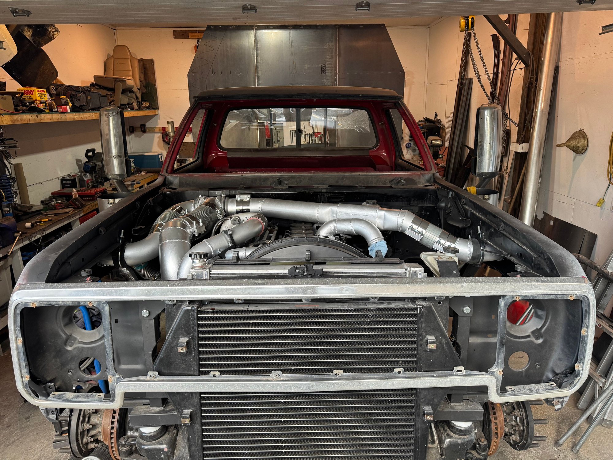

Everything is back together, have 1 1/4” of clearance, wouldn’t mind a bit more but think it will suffice.
Ended up using your tip Oliver, since my new modifications moved the fan upwards, as well as spaced out from the rad more at the top then the bottom. Little 1/4” lift at the transfer case made the difference.
Got the stacks started, will finish tomorrow and move the truck out under its own power, so I can give it a little stationary break in.
