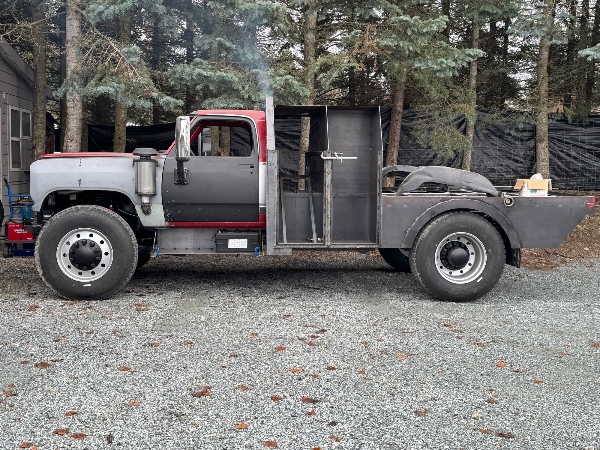

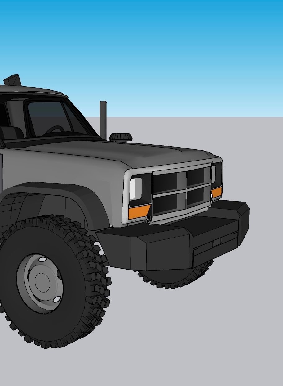

Not far off from the 3D design I did a few years ago. Definitely needs the side steps and front flares to tie everything together. A little empty below the doors at the moment.

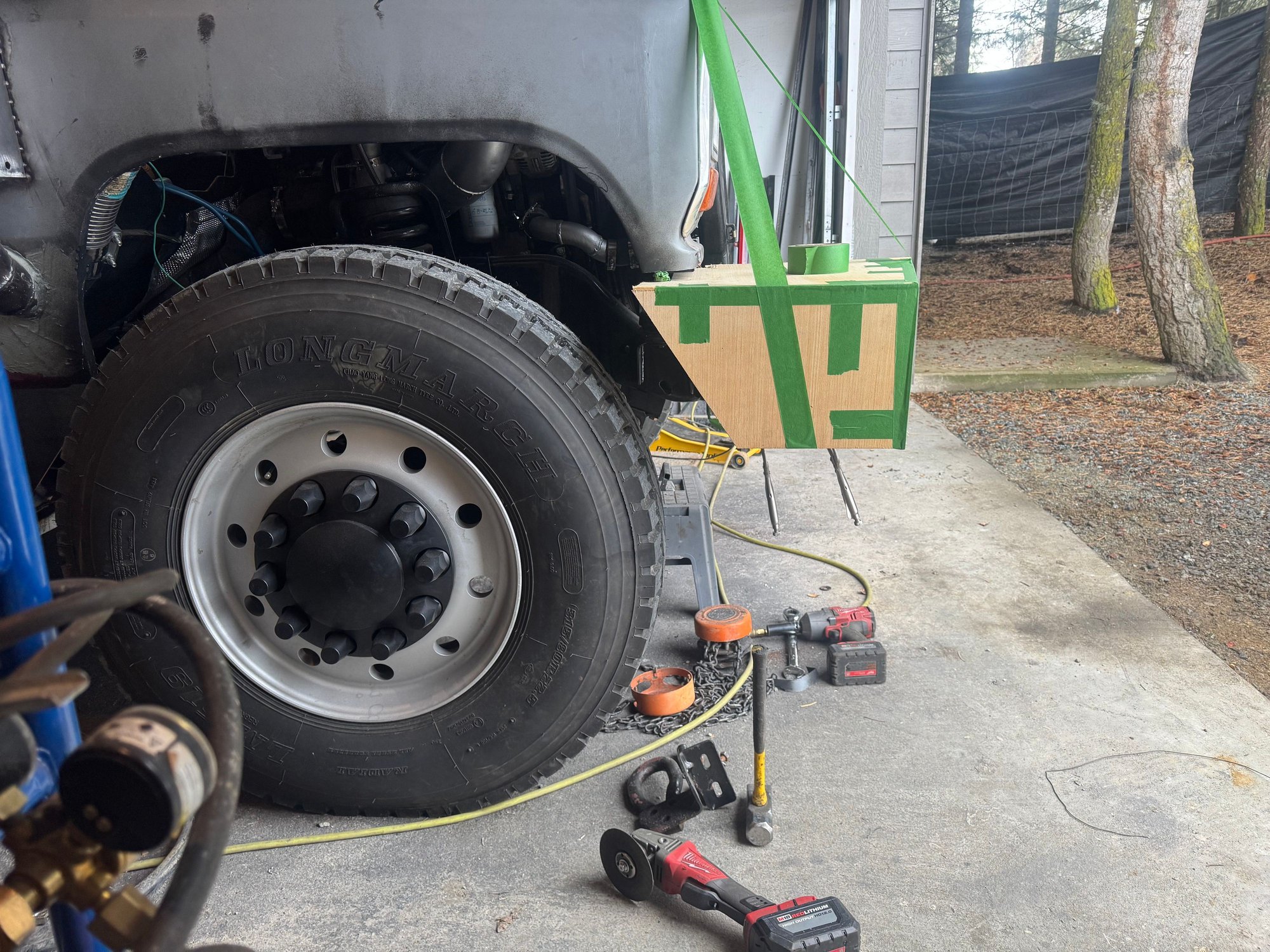

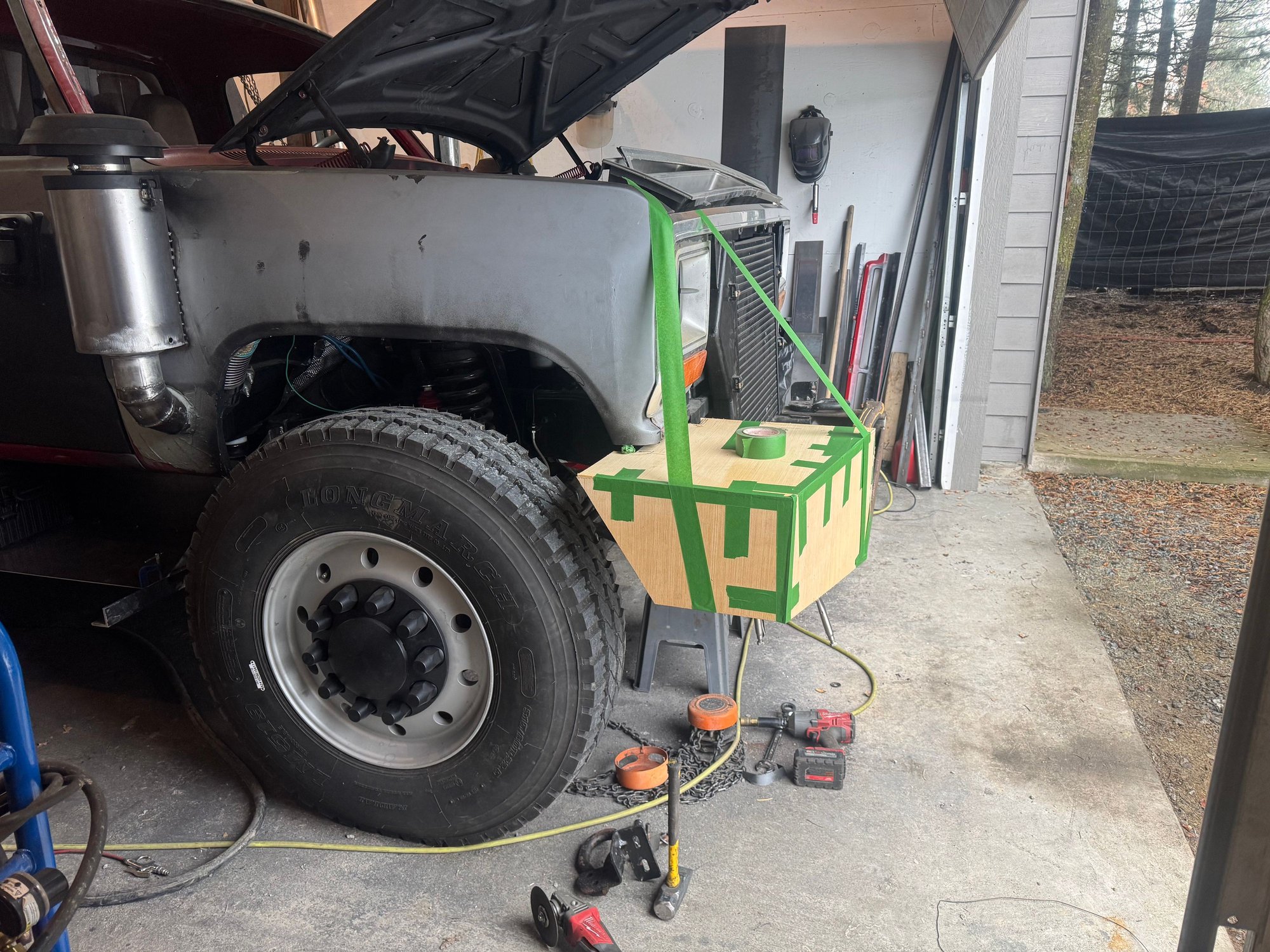

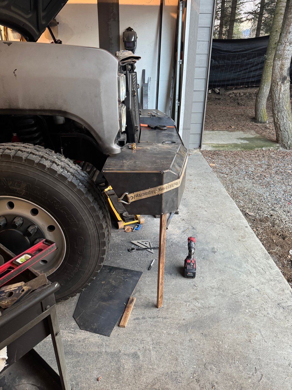

Mocking up the front bumper. Going to stick out like clown shoes, until the fender flares tie it in. Wanted it big, so that I have a platform to work on the engine with. A little bit of changes needed, to refine it.

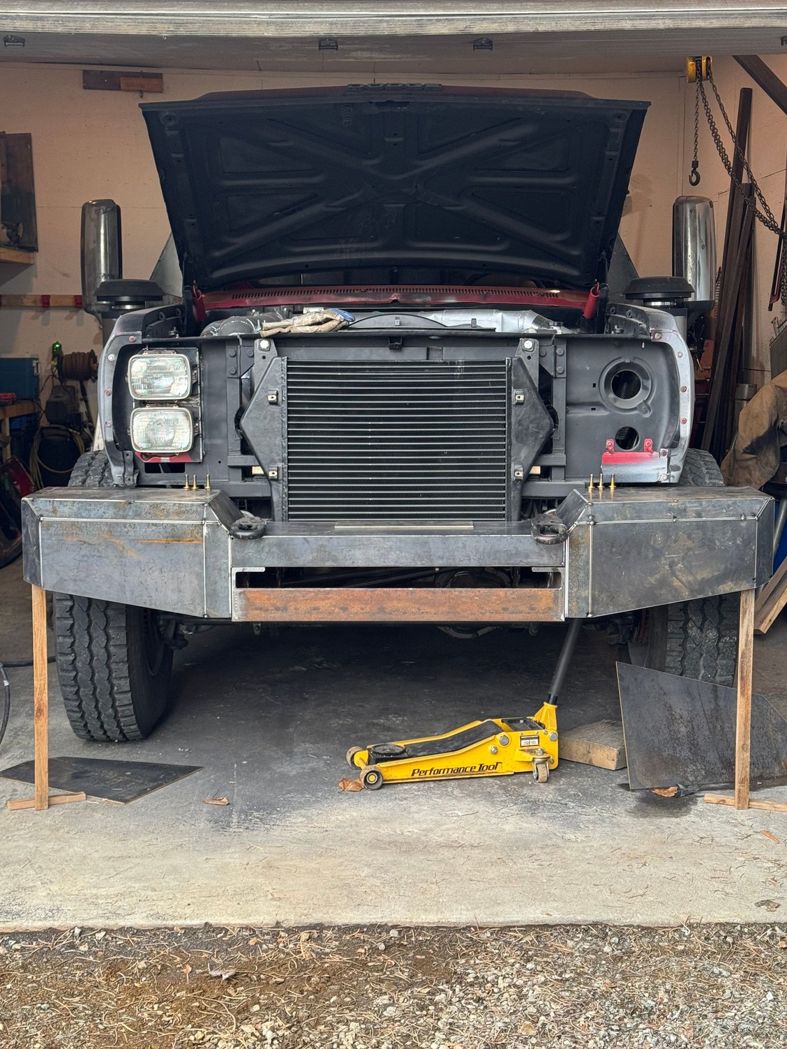

Finalized the design and drew the parts up in CAD. Sent to a shop near by to have the pieces cut out of 3/16”. Should be ready next week, so that I can start putting the bumper together next weekend.
Bumper may inspire me to make the fibreglass flares next.

Haha! I’m very familiar with such CAD. I was going to use cardboard cad, but had some thin sheets of wood laying around. So, WAD?

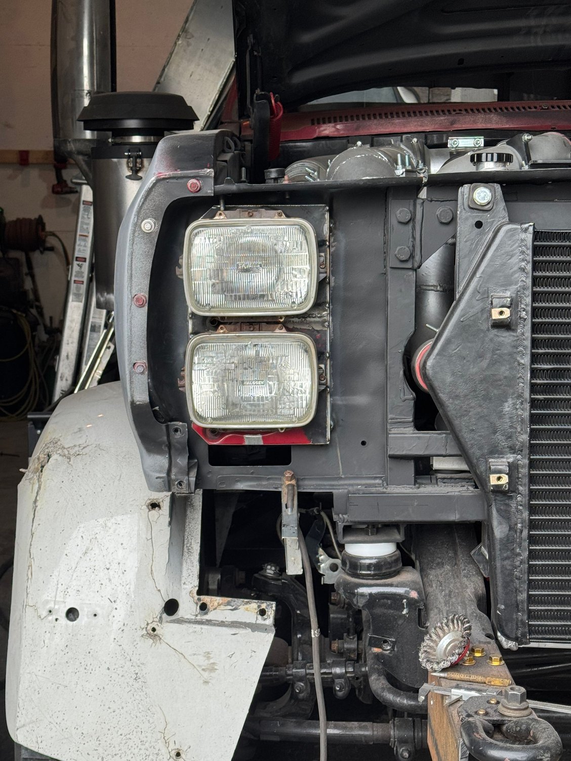

Unfortunately, will not be able to use a stock grill, in any way, non intercooled, or intercooled. Will have to make a custom grill, so figure I may as well do something fun with the headlights. Quad lights anyone?

Nice look, just like the ‘79’s
Same way I installed my round head light bucket in my 2wd Ramcharger build using a ‘90 core support. I ended up mounting them over cut outs I made in the core support, rather than trying to weld them in flush and hope the placement was spot on when I put the grille over it. This gave me more wiggle room to adjust placement during assembly.

Had a little time to tack the right side together.

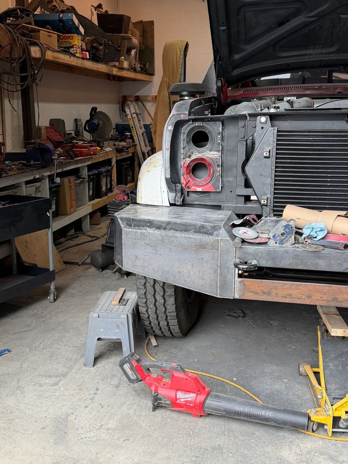

Little more progress.
Main middle bottom section that bolts to the frame is 1/2” 6x4 angle, that will mount a winch down the road. The outer sections are 3/16” bolt on pieces, along side the middle top section, that can also be removed. Making it modular, so that removing the bumper, if need be, will be a one man job.
Once it is all bolted together and straight, I’ll start working on the fender flares, since the bumper now makes the truck look a little goofy.

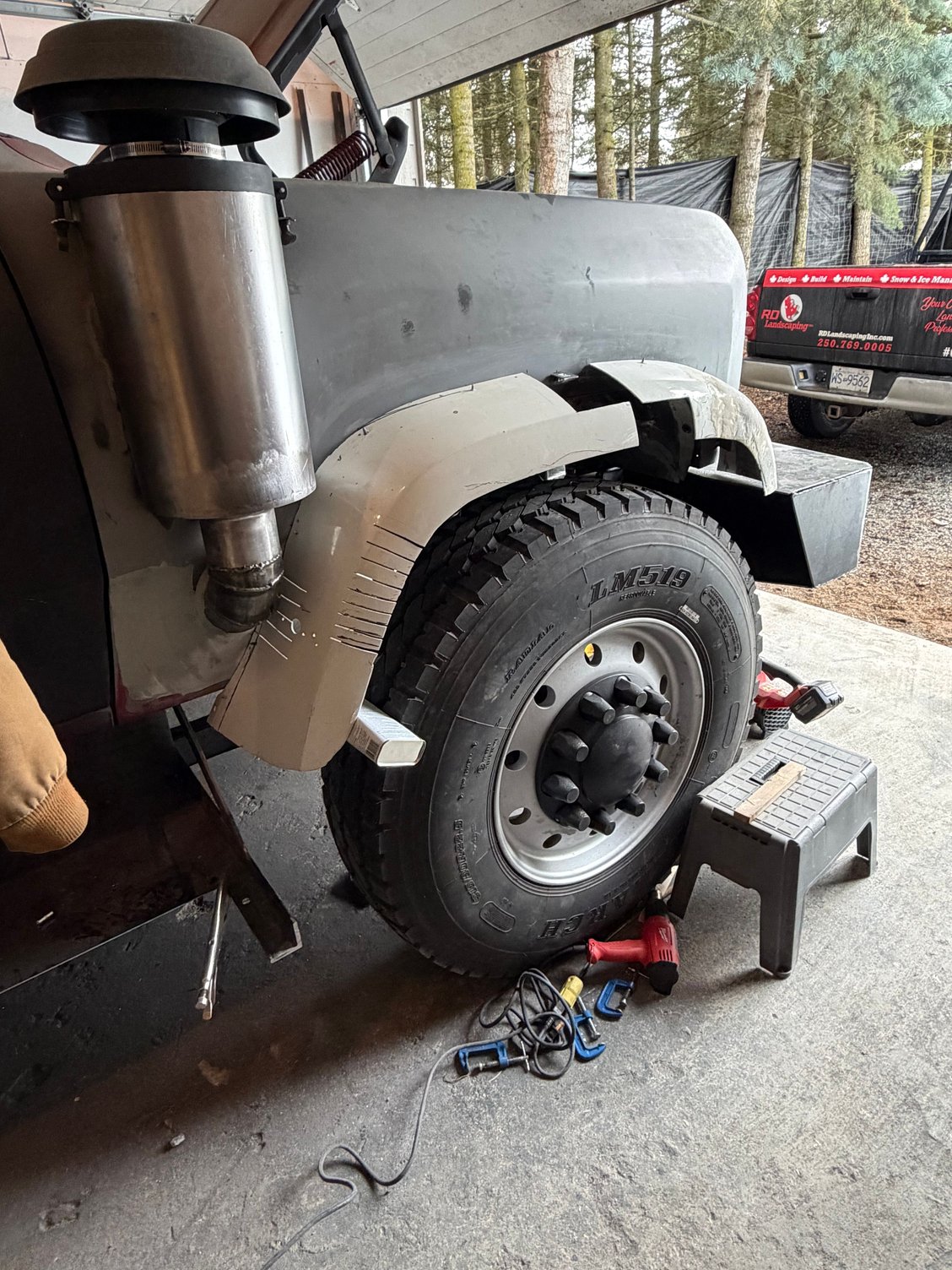

Not entirely sure yet how I feel about it. Will trim the lip up about an inch all around.
Edit showing trimmed, looks a bit better.
