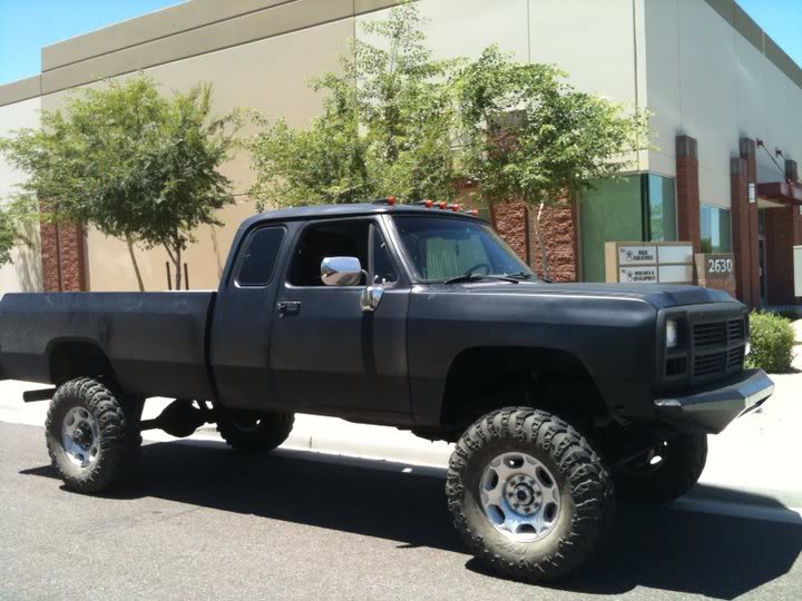

These are off of an '08 I was told. Machine out the center and away you go. I think they look better on a dually front axle...
