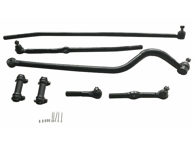

Often overlooked- trackbar balljoint shot. Get a helper to wiggle the steering wheel left to right with the truck on the ground and observe the balljoint connecting the trackbar to the frame. No movement allowable. Also observe the track bar bushing on the axle- also no movement allowable.
Any play in there can induce the death wobble, simply by the axle going to the right- wheels steer towards the left, axle goes left, wheels steer right and so on.
The damper between the tie rod and the axle is a band aid at best..

I had/have the same issue on my 95 2500 4x4. I replaced everything, ball joints, tie rods, ect. I found that the long bar with the long bar that goes from passenger side lower to the driver side upper, was the issue. I dont remember what its called but it has a curve in it on the driver side. I bought one from autozone, it corrected the problem for a little while. The autozone one was cheap, get one from dodge and make sure oil doesnt leak on it.

The long one with the curve in it is the track bar. Keeps the axle centered under your truck. Balljoint on the drivers side of the frame wears out, often resulting in death wobble.
