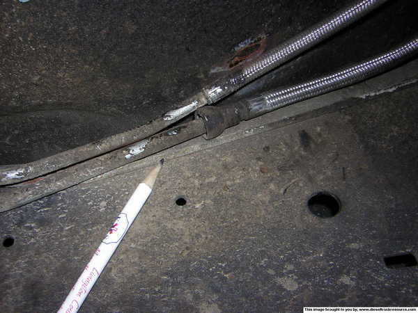

Not sure why he said the entire line needs to be replaced. You have metal lines along the frame rail, then they become a section of braided line, then a short section of metal, then a short section of rubber hose which connects again to the metal lines that bolt to the fuel system components.

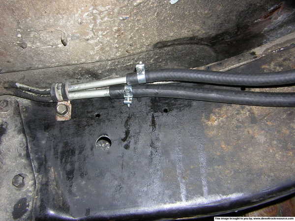

To me, that is to many connection points, so I cut the line at the frame where the braided sections begin, flaired it and installed rubber line the rest of the way up to the metal lines along the engine (the ones that connect to the prefilter and the pump).
This is the connection point before cutting and bellmouthing (flairing) the ends:
This is the fuel lines after everyting has been connected:
It eliminates all those conection points, potential for leaks in the hoses (metal, rubber, and braided) and makes life easier next time you have to replace the lines. The rubber tubing just gets routed in a safe location with a few zip ties. I used wire loom over the hoses to protect them at critical points.
