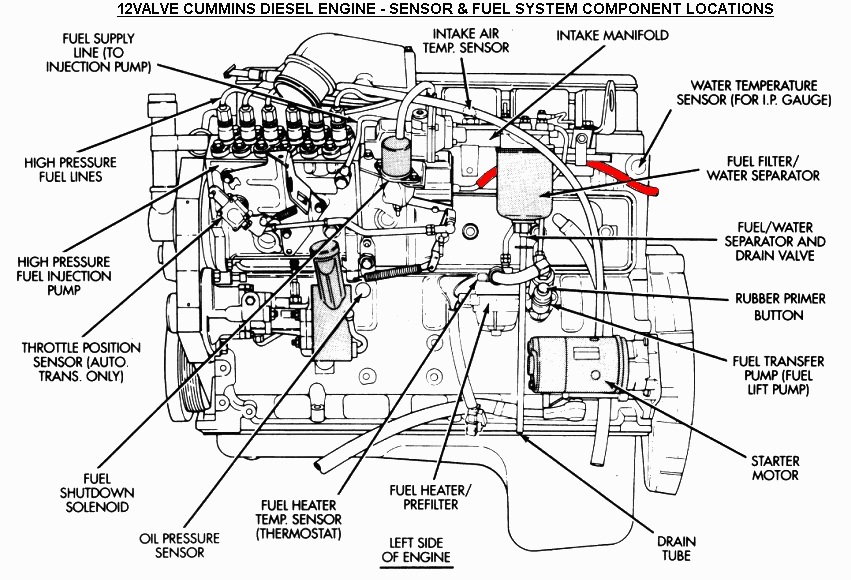

Have a good look at the rubber return hose that runs from the back of the injection pump, down the rear of the engine and leads to the steel return line above the bell housing. Changed many of those. They get cracked and weathered, end up leaking lots of fuel, but start out by letting in some air when they first start causing trouble.

well... I loked...there are like two or maybe even three of them....not sure which one could be the culprit. Do you know?

I'm thinking he means the one in red.
