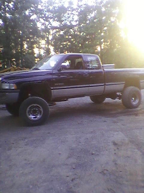

Hi guys,
well this whole thing started in august when I got the great Idea to buy a almost new Skyjacker lift kit. I bought it for $400 and I traded a junk minibike for it. about $300 later in parts that were missing I have a complete kit.
So late august and early september I am putting this lift on my truck. After many small but workable issues it is all together. About 3 weeks later the Carrier bearing is toast.
Two days later I put a new one in. ( I drove it on with a hammer and pipe because I don't have a press ) all problems seemed fix. It had a minor vibration.
mid November: Carrier Bearing pops out of rubber. So I popped it back in and shimmed the bearing so the drive line is in a straight line. From what I am reading this is bad.
about a week ago the rubber just ripped to shreds. I have been running the truck and popping the bearing in. It still pops back in but it will pop out after x amount of miles. I try not to run it if it pops out. I got a new bearing and I need to put it in tomorrow and get it fixed because I have to go about 45minutes away on Christmas day.
My lift is 5". From what I am reading you want the tailshaft of the tranny and the Pinion shaft of the rear to be parallel. The way my truck is now I have the pinion shaft pointed upward diagonally toward the tranny. I put the shim in that came with the rear add a leaf.
I don't know what to do. Do you think I should take that shim out so the two ends of the shaft are parallel?

u joints shud have no more than 3* of angle on them to get good life out of them. what you might try is angling the pinion up to ease the strain on the carrier bearing. summit sells wedges you can install between the axle bracket and the leaf pack also make sure your driveline yokes are phased correctly

as far as phasing the driveline make sure the u joints are all clocked the same on the shaft. if the slip yoke has been installed incorrectly it can cause a vibration due to this also be sure to check them all for any binding or tight spots. do i presume correctly by shimming the carrier bearing you lowered it down off of the crossmember
Also check the condition of the yoke in the rear axle. Mine spread about 1/32'' and wouldn't hold a u-joint tightly. Replaced the yoke and vibration was gone. Good lookin truck-give a shout if you're up near Binghamton--always up for bs-n and tossing back a cold one

Well today i threw it back together. I think the first time I did not press the bearing on correctly. so i took my shims out from the bearing cause the driveline angle looked funny. Now it is almost a straight shot. maybe a few degrees off.
Hope it works, If not Im going to build a one piece shaft. Dad is a welder by trade so he will build it and I will take it to a shop to balance it for me.
