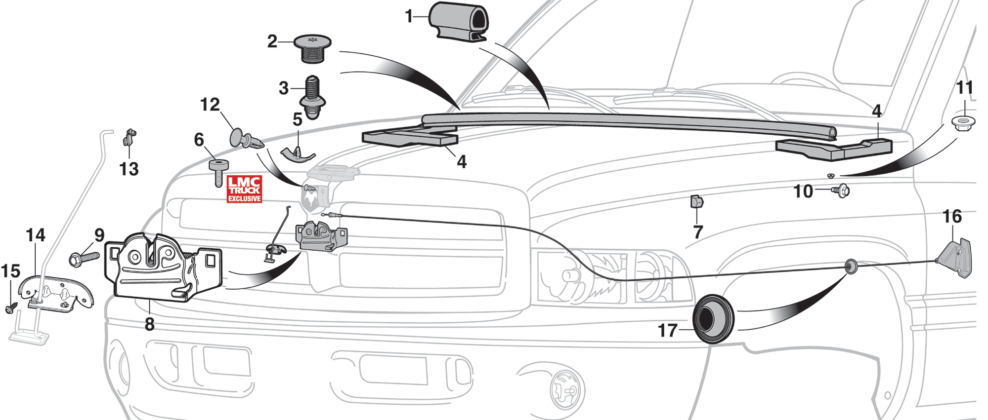

I'd use some (a lot) sound deadening material on the rear of the cab.
If you have everything out, drum on the surfaces with your fist. (easy does it) You will find where the sheetmetal resonates a lot :-)
You can also stuff a pool noodle in the front fender just in front of the door. (helps a little with the high pitch noise from the front)
Check the weather striping of the hood, if you have lost some of the parts like #1 and #4 in the pic replace them

Many thanks
[QUOTE=AlpineRAM;3375864]I'd use some (a lot) sound deadening material on the rear of the cab.
diagram will help thanks a lot.
