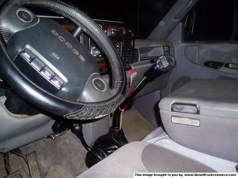

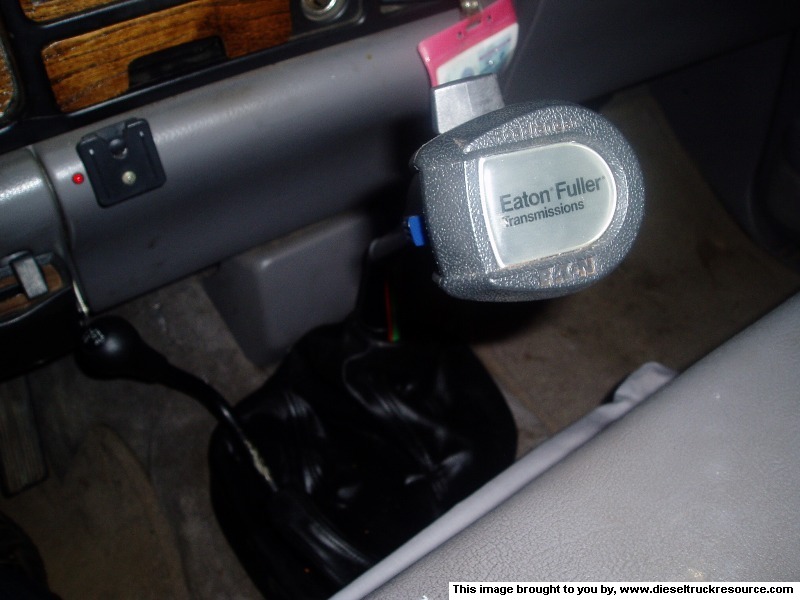

The petal assy shifter boot and slave cyl from a 1500 gasser is the same which is easer to find than a salvage cummins. I had a dealer in my area that had all of that stuff but I don't know if they will ship or not. Here is my costome shifter setup.
Attached Thumbnails Anyone know where i can get manual conversion stuff?-shifter1.jpg   Anyone know where i can get manual conversion stuff?-shifter2.jpg
