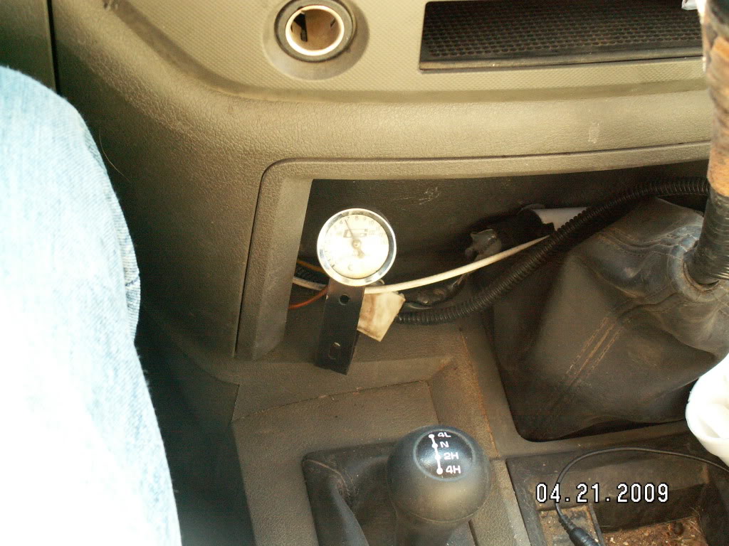

I used a small copper line for a lube oil pressure gauge on my old F250 - installed over 20 years ago and absolutely no problems. yes, the fluid (oil, fuel etc.) is deadheaded.
For my fuel pressure gauge I used a 0 - 30 psi Isspro gauge. I installed a needle valve on the VP pump at the shraeder port (replaced banjo bolt) and the connected up an isolator to the fuel line. The outlet side of the isolator runs to the truck cab and is filled with antifreeze mixture.
Works well and I have had no problems so far. My lift pump is the Raptor replacement pump (100 gph unit) and is set for 18psi idle - 15 psi at steady 60 mph (100kph).
So far all looks good. A great pity I did not install the fuel pressure gauge long ago when I bought the truck new. I have just recently had to replaces the VP44 pump after 100,00 kilomters or 60,000 miles. Expensive lesson learned at $2,000 - ouch.

A note on "isolators":
Generally these use a diaphragm to transfer pressure from the fuel to another fluid (usually coolant).
Unfortunately, the majority of these diaphragms are not robust against diesel fuel, and eventually you will have fuel into the cab (and coolant into the VP!).
The best way to "isolate" the pressure signal to the guage is to have a restriction into an expansion tank/accumulator of some sort on the way to the gauge.
I've been running fuel into my cab since 2004. The only time I had a problem was when I plumbed it with plastic tubing at first. Since I've used grease gun hose to the guage, I've had no problems.
I'm about due to inspect and repair my installation, as GG hose tends not to age very well and I suspect that I have an accident waiting to happen with my gauge installation.
