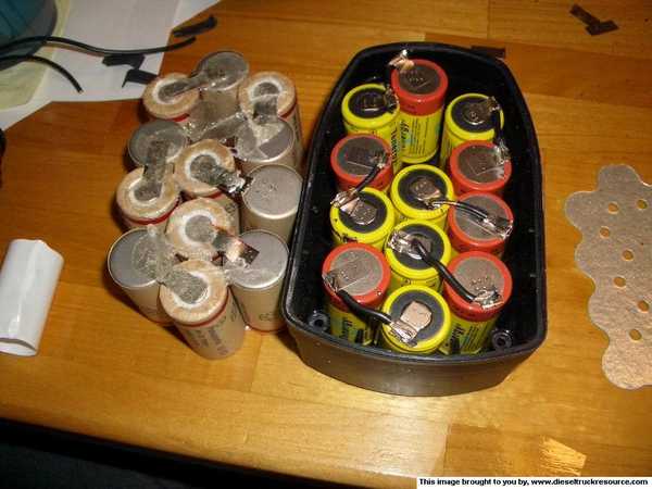

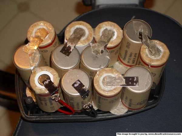

Here's a shot of the sub-c's that were in my drill pack...
And a shot of new cells, wired the same...
Like $15 worth of batteries. Again, doing something like this would be an "at your own risk" thing, as these things have enough power to cause a fire if shorted...
Seems to run fine, and have higher capacity than it did from the factory, but I don't leave it unattended when charging.

Jeff, where did you get the C cells with the Tabs on them?
that was what i was afraid I could not do, solder tabs on the batteries.
i could do what you did, easy enough.
An e-bay seller called all-battery. I ended up with batteries with tabs because they were cheaper in the quantity I needed to repower two battery packs.
They were easy to solder to, but cutting off the excess tab (so they couldn't short) was a bit of a pain, and also the added height of the tab, solder and wire made it tough to get the case back together (but I jossled things around and got it to close).
Next time I think I'll try the plain tops, and a bit lighter wire, but like you I've never attempted to solder to them.
Not shown in the photos I posted was a temp sensor that was shrink wrapped to one of the cells. It was no big deal to tape it on to one of the new cells.
I looked at the rebuilding services, too, but they would have been like $45 per pack when you figured in shipping, which is getting too close to the price of new. This set me back about $30 to do both of them with higher capacity cells (these were ni-cad, and I stuck with ni-cad).
